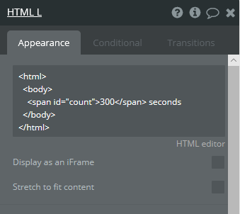

Back on your page where you have your Input field to be typed into it, add a HTML element under it and past the following into it:
<html>
<body>
<span id="count">300</span> seconds
</body>
</html>
Now try typing into your Input field, see if the workflow triggers and the timer starts to countdown from 5min (it’s in seconds but you can probably change that)
The html isn’t changing at all for the second one. Your first response is much closer to what I want, so I’m trying to make that one work. The problem that’s happening is that the timer doesn’t start after my input’s value isn’t empty and isn’t restarting when I refresh the page.
So with the second one, the timer should start as soon as the input’s value is changed and when you refresh the page it should reset again. If you could perhaps share your app and show me what you have now (or make a copy of what you have) I could take a look and make it work for you
Try it now @samanthadibble314, I’ve just changed the workflow to a do when condition is true and set it to just run once. I think before, that JS was running every time the value was changing and messing things up.
