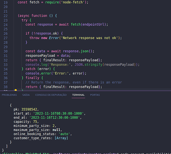

Hi,
I am trying this approach already and this is working using vscode IDE.
But I am not being able to fetch from bubble.

  (async function () {
    try {
      const response = await fetch(endpointUrl);
      if (!response.ok) {
        throw new Error('Network response was not ok');
      const data = await response.json();
      responsePayload = data;
      return { finalResult: responsePayload.json()};
      console.log('Response:', JSON.stringify(responsePayload));
    } catch (error) {
      console.error('Error:', error);
    } finally {
      // Return the response, even if there is an error

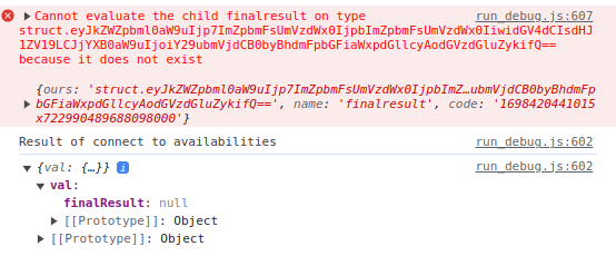

And this is the value I should return:
I am not sure what I am doing wrong.
I have even tried with a public endpoint and it does not work·
