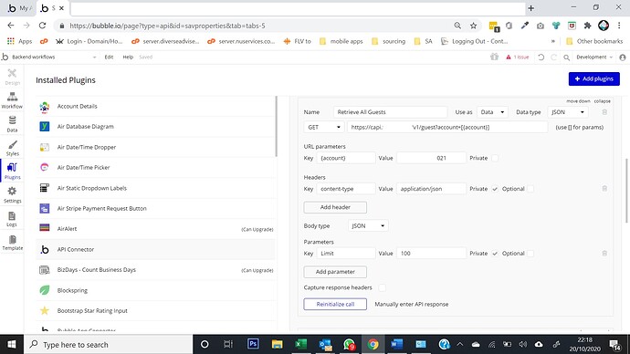

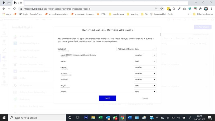

I created an endpoint AddAllGuest as a test with parameters pName, pPhone and PprimaryEmail as a text.
Then I created an action to add as guest with fields Name=pName, Phone=pPhone & Primary Email=pPrimaryEmail
All connected and i ma getting data as required from API and adding in Database , but its adding as Guest.
which is showing good and i am happy to see that data is coming through.

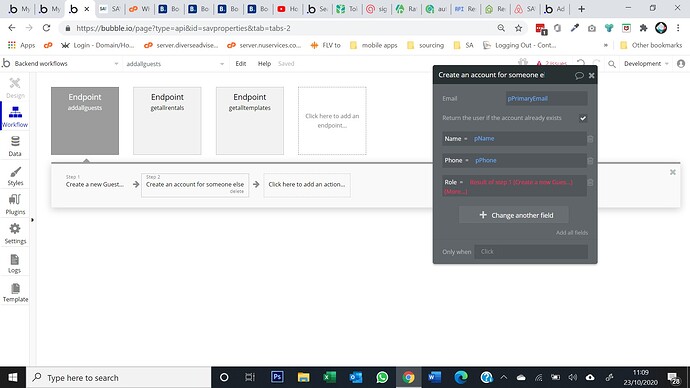

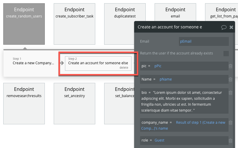

Which bit in particular is unclear to you @sanjay? You are already using an api workflow to create guests. I’m suggesting that in that workflow, you add a step to “Create an account for someone else”. It might look something like the following:
Hi Louisadekoya
great thx so, in the example above
step 1: I add guest
step 2: I create account for someone else (guest in this case) .
but how do i tell system that the account I created is a guest user or do i have to attach the guests role somewhere>???
thx sanjay

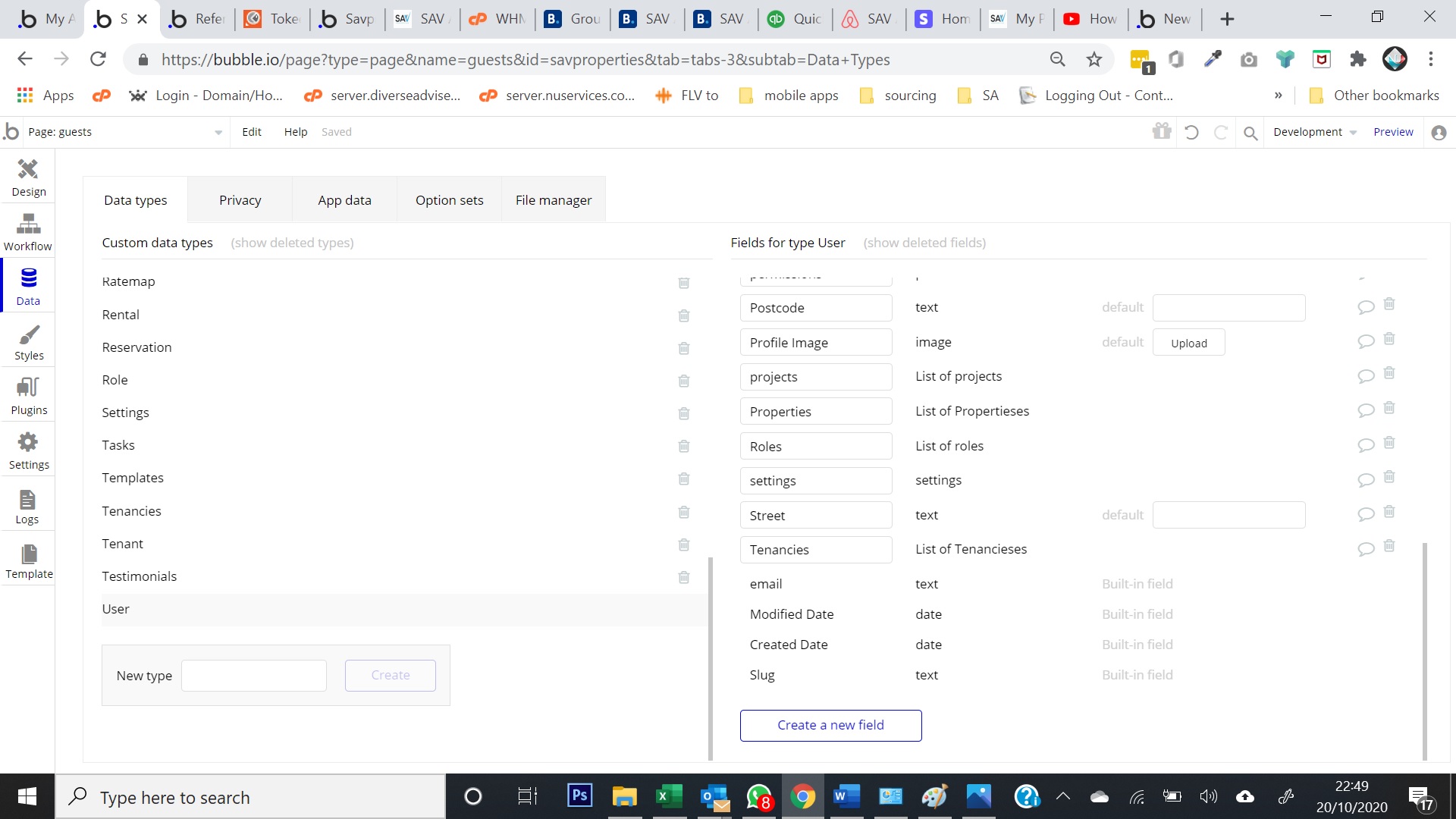

hi Louiseadekoya
I dont see guest as role
I created all different users, cleaner, Landlord, Guest,Contractor & tenant as a filed in user Type as list of users .
then i created a data type called Role with field name (Landlord, Landlord, Guest, Contactor & tenant)
and created a field in user data type as Role
Then went back to do the step in my workflow but i don’t see role=Guest( its not there
am i missing any step??
see screen
Hi @sanjay, in that case, you need to do a search i. e Do a search for Role (constraint: name = Guest)'s first item.
A better way however, is to not create a data type called Role. Instead, create an option set called Role and add the different roles to it. You should then be able to do what I did in my screenshot. If you haven’t used them before, you can find information on option sets here in the forum.

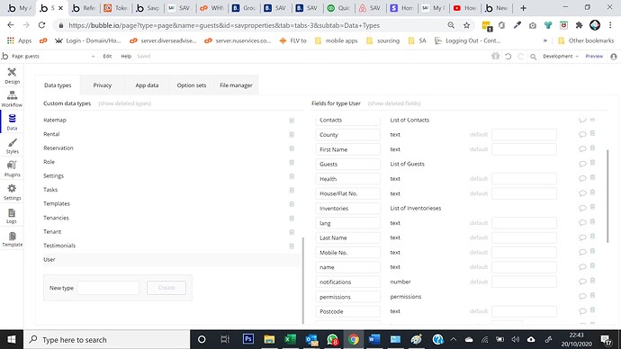

now i mange to do what mentioned and manage to create guest and then make the user and user option set as role.
after doing that, now the email came from api for the guest is gone in the User type and all other data like name, phone etc have gone to guest data type.
Is that normal and how now if i want to create a list of guests shown in RG. do i make RG’s groups content as user or guest ? as email is in User and other data in guest tables??
thx
This is why I suggested that you could do away with the guest data type altogether and put all the fields in the User data type. Only users with a role of Guest would need to use these fields. Without knowing the details of your application, I would say this is likely what I would do.
Still, even with your current approach, you can add a user field to your guest table and when you create the user, you add that user to the guest record. That way your repeating group can be of guests where user = Current user.
