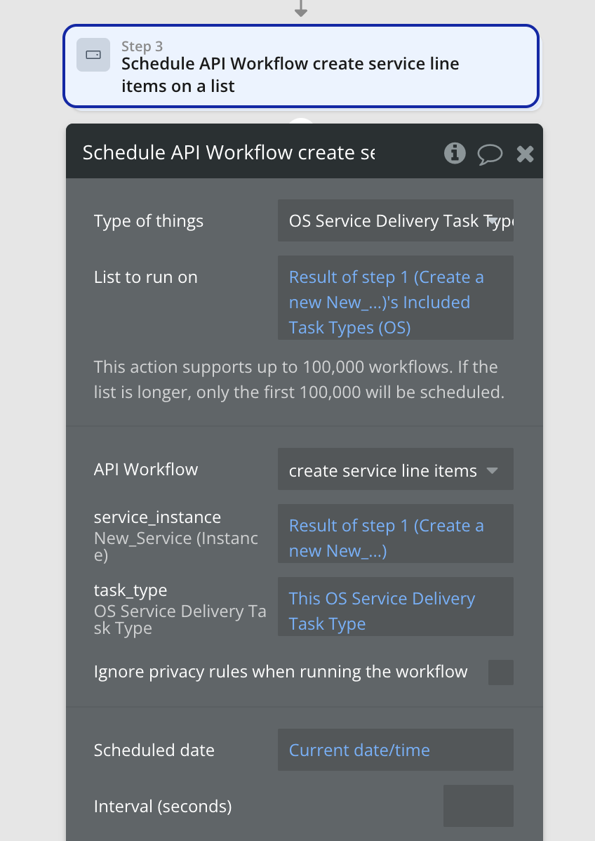

The API Workflow takes in a ‘Service Instance’ and a list of ‘Task Types’. Here’s an example of where I call it:

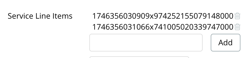

4x ‘Service Line Items’ are created in the above test scenario:
However, only 2 of them end up being added to the ‘Service Instance’ - Sometimes it’s 3…
