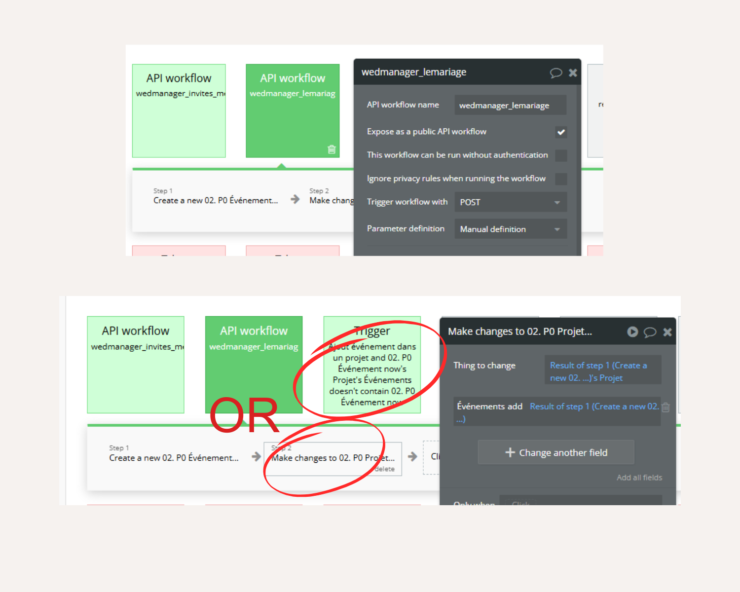

Hi !
I would like to create a “list” of new thing from a multidropdown.
For this, I followed this very good tutorial: https://www.youtube.com/watch?v=LLYaNHmt6_Y&list=PLvRZVR4itmEuaXL3VPh1-_nI_NbSpKeXD&index=25
However, after the first task of the Workflow API, I would like to add each created item in a field of another list.
This works but the list is never complete, one or more items are always missing.
I tried to add the task via a trigger event, and it’s the same thing, it works halfway, items are always missing.
‘I think’ the problem is that the first task of creating items is not completely finished when the second one starts. But I don’t know how to add a waiting time between 2 tasks … and I’m not even sure that’s the problem.
Thank you for your help !

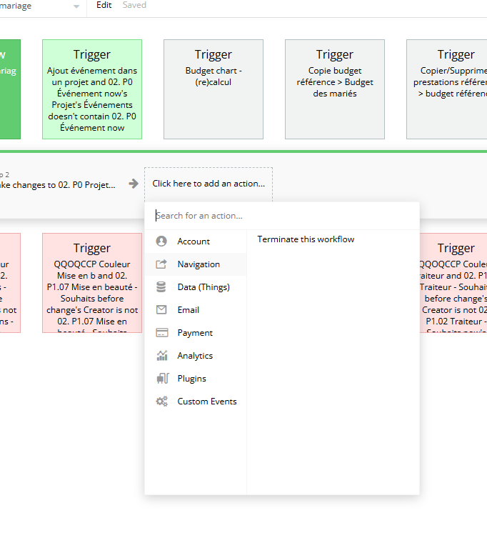

Thank you but this action doesn’t exist on backend workflow …
I know … But in this situation, it’s the only way … :sweat_smile:
