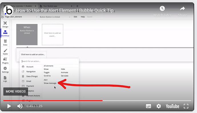

I want to show a popup alert when an action is performed by a user. This Bubble video explains how this is achieved by using the ‘show message’ feature (first image below), but I don’t have that feature?
Have you added an Alert element to your page?
You need to have an alert element on the page before it will show up as an action in a workflow.
I hadn’t done that, what a dummy! Thanks for info!
