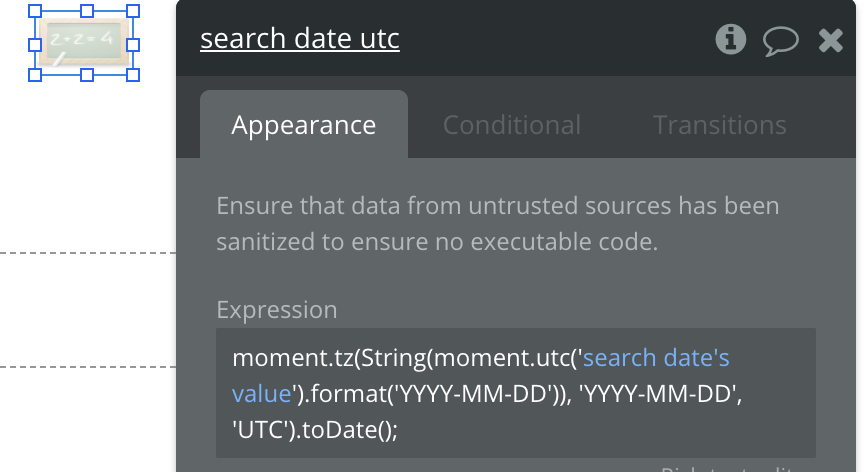

myDateInAnotherZone = moment.tz(String(moment.utc(myDate).format('YYYY-MM-DD')), 'YYYY-MM-DD', zone).toDate();
where myDate is a JavaScript date and zone is a string that represents what Bubble calls the timezone ID (and what moment calls the zone’s “name”).

Once those scripts are loaded, you can access moment-timezone like I did in the single line of code above.
