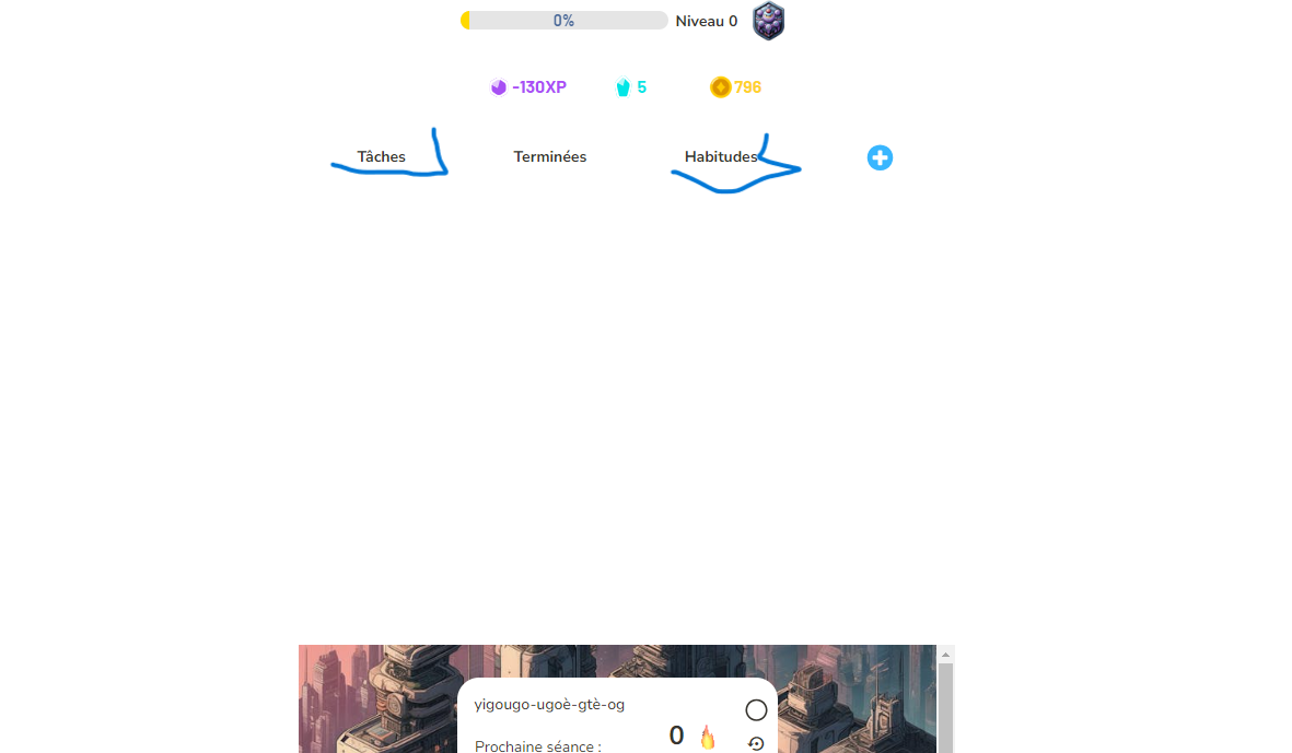

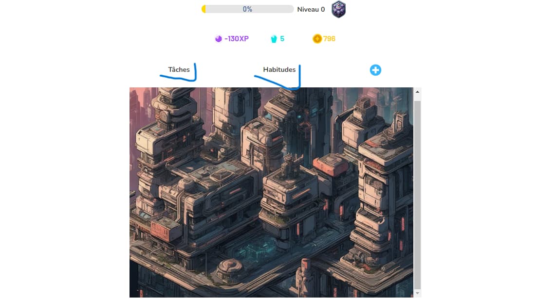

HI I have a problem with some transitions animations . I made two workfows to animate groups by clicking a text but sometimes one group does not collapse when hidden , its frustrating for the user experience . Help me please

That animation of sliderightIn is to show something, not hide it, so the collapse when hidden would not work as you are showing instead of hiding when using a transition that is ‘in’ you need to use animation that is ‘out’
Ok thanks a lot for your response I will try that , so what animation should I use to make transitions or to show groups ?
