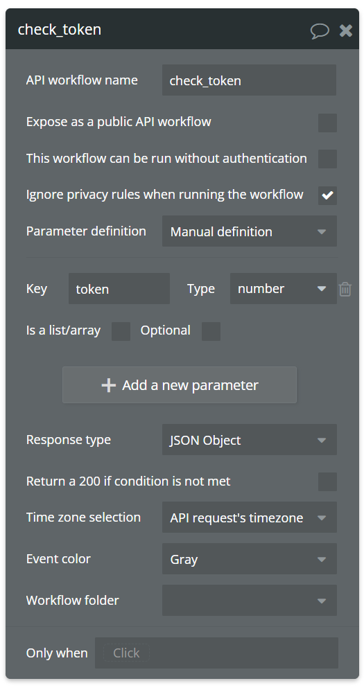

My API is visible and initializes when I make it public, but I don’t think it should really be public.
I have set up the API key, as well as the API itself, but as soon as I set it as not public, the call can’t see the workflow anymore.
The API is supposed to return a value, whicih is does when public.
Any idea what I could be doing wrong?
You need to expose the workflow as a public API in order to access it from the API connector.
Also… you have set GET request, but the backend endoint seem to be set as POST (however ,actually you don’t see the option to switch to GET because public is unchecked like @adamhholmes said)

It looks like you have added Authorization twice. Delete the one inside your api call under ‘Headers’. It should work fine then.
