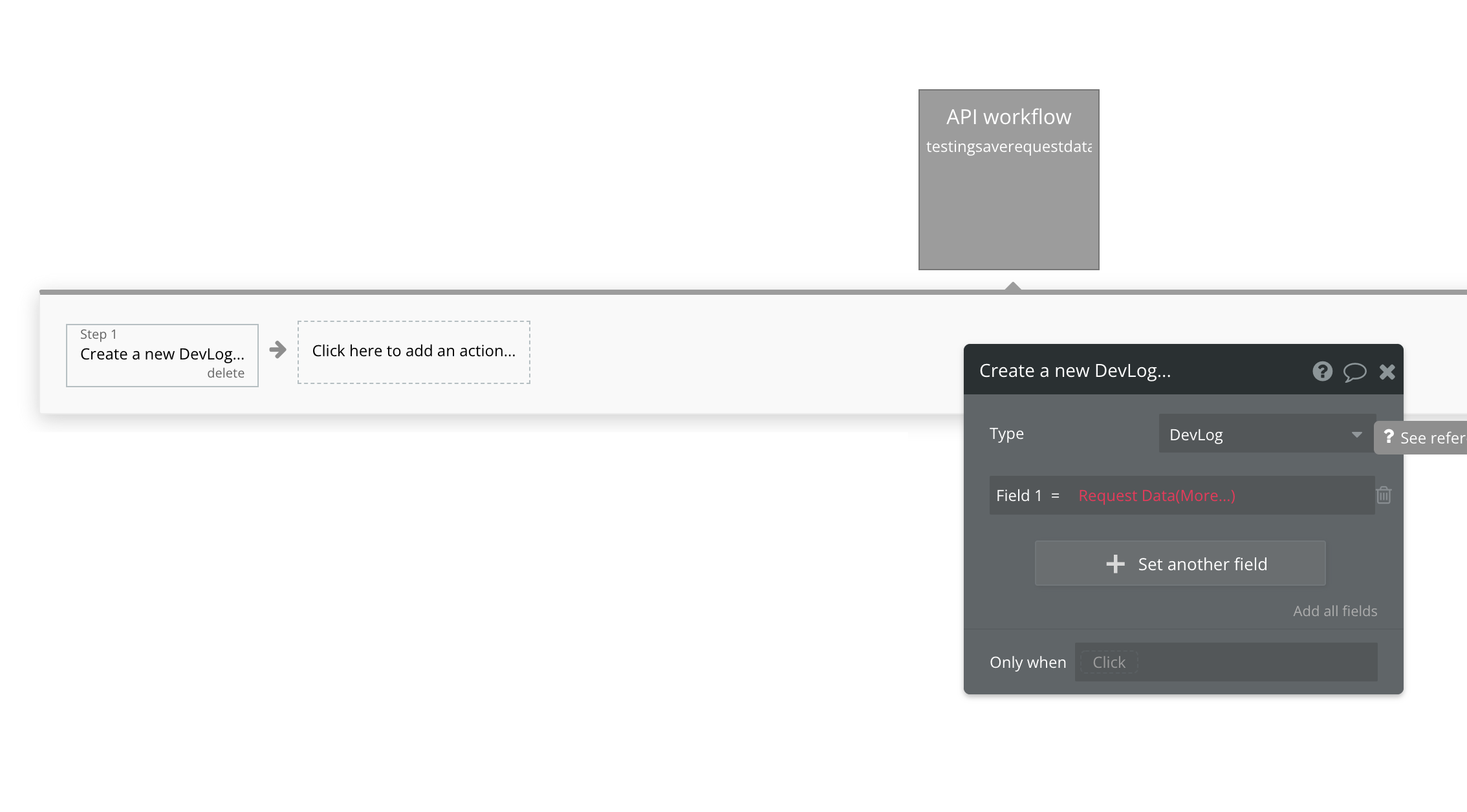

Has anyone figured out how to save the whole request data body to the database? Not just each part separately. It would be fine to be saved as text but I haven’t been able to figure out a workaround for this.
If anyone has any ideas, I would appreciate it if you could send them my way. :blush:

I found a funny way of doing this :smiley:
If you already aware of the format the Request Data will come in with, you can just rebuild the JSON as an arbitrary text and then save it to the database.

I think the problem is that I have way too many fields that I don’t want to have to go through and map each one like that. Also, I was hoping to accept whatever is sent. No matter what the structure is. Even if it’s different.
I will keep it in mind though. It might not be too bad though. It’s worth giving it a shot. Or at least it might spark another idea from doing it this way.
Thanks for the out of the box thinking. :+1:
If it’s a webhook, the API you are working with definitely has a sample request template (a “what to expect”) JSON. Literally just copy paste the whole thing and replace the values in between the quotes with the dynamic data!
