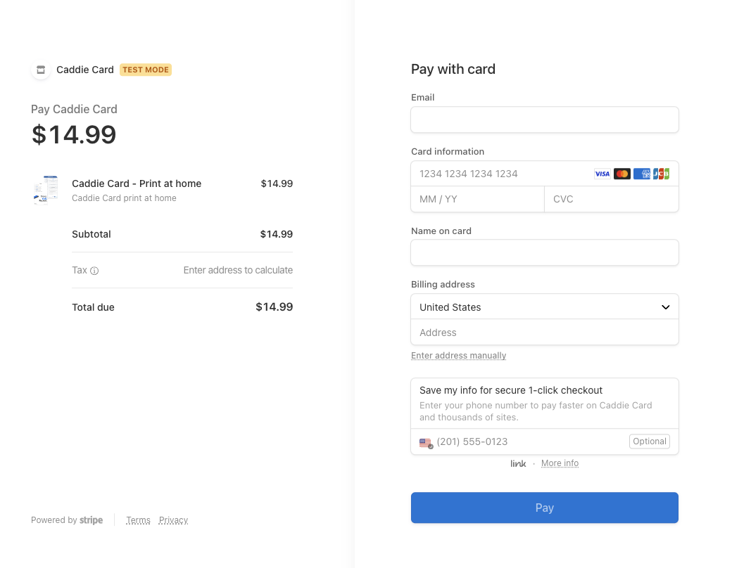

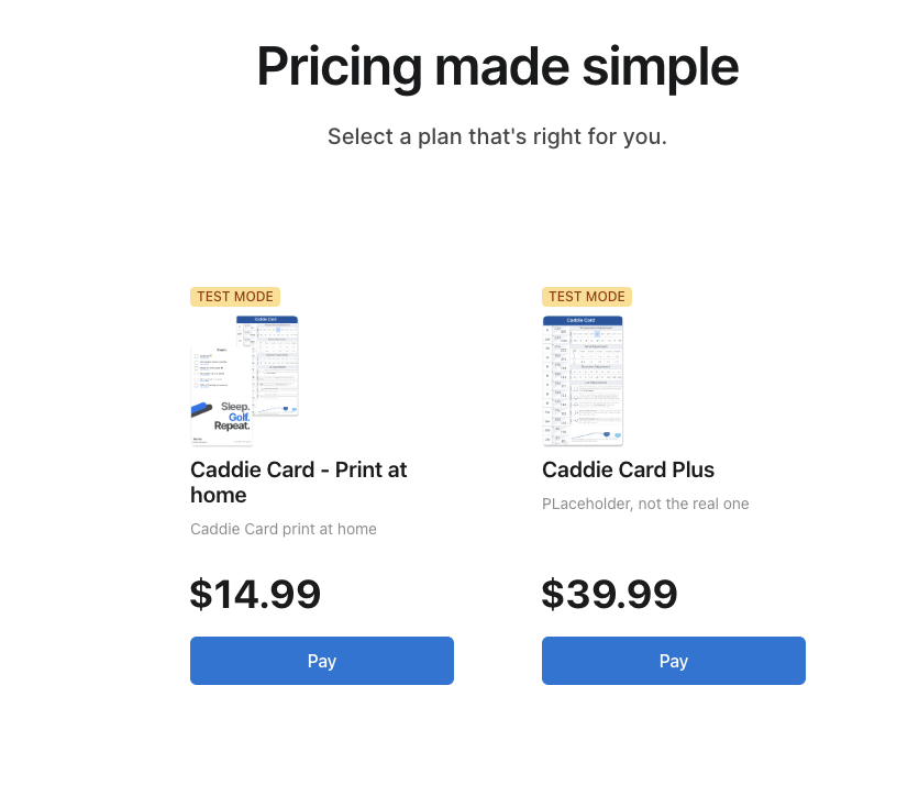

Stripe now has a new pricing table feature that you can just drop some HTML on your page and load a pricing table like this on your page. It then brings you through the Stripe checkout page.
You can setup a API workflow to send to send over the customer Unique ID, and use a webhook to match the checkout with a customer in your Bubble Database. Only issue is, the customer needs to be logged in first.
This is a weird flow. Anyone have any ideas how I could capture and match a customer ID with someone who hasn’t logged in? I’m thinking I could prompt customer to create an account after the purchase… thoughts?
