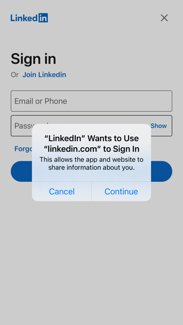

However in iOS when user tries to Login with Linkedin, it opens Native iOS Linkedin app instead of Oauth login on the same page.
when we delete the native app things are normal.
Also it shows this message
and if we press continue than bubble linkedin Login is directed to Native app, and if we hit Cancel Oauth works fine.
Is there anybody who faced the same problem? or this could be a bug.
