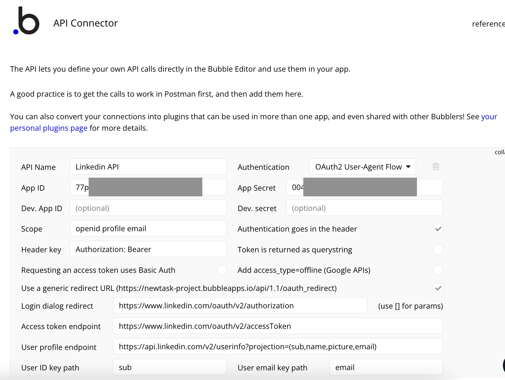

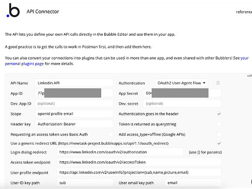

The good news is that you can use API Connector to create the Sign in with Linkedin feature pretty easily. Using Linkedin documentation and old documentation you can create the connection and retrieve the data.
Here are the settings for API Connector to set this option:
In my endpoint, I am only retrieving email, picture, name, and ID (sub) from Linkedin as Data, but it is possible to get other parameters in the response body.

@psycholabdesign you’re right thanks for sharing. I ended up using the same API configuration after watching a couple youtube videos on this topic.
@psycholabdesign thanks for sharing. I have the same problem and will be shifting to this solution. Thanks!
