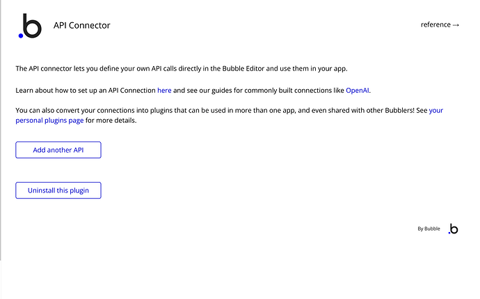

On one of my app, in the api connector, i can’t see all my APIs anymore. It looks empty… I still can call the apis i had here from my workflows (and it works…) but i can’t see or edit it from api connector…

I did try from another app, and i have no problem so i wonder why/how only this app is affected?
already tried from different browsers, computers / Clone the app but i can’t see the apis in the api connector on the clone either.

Thank you very much Emilio López Romo who gave me on slack a solution to at least see it and make sure it is not lost.
“If you need to see it, you can find it in an incognito browser. That lets you see all the api connections”
But i still look for a solution to get it back on normal browser.
I am going to reset cookies for now.
