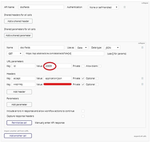

I am trying to get data from another application to bubble app through API request in which I want to enter dynamic token number. While creating params for that in API, Bubble asks to enter at least one value for the key.
- I’m not able to save the API call if I enter any string, so I am supposed to enter any valid sample token number. I want to call API though I enter any string value.
- The entered valid token number binds with the path id when save it. As a result, I am not able to call API for the dynamic token number I enter in UI.

Hi @rpetribu,
We used the mentioned brackets in the call.
Let me share the specific part where I’m stuck with images.
For the specific key, we’ve given a dummy valid value.
While we try to map data to be displayed in the UI, it shows like as it is hardcoded (being not able to get data for dynamic input).
While for other similar API call, we are able to get data for dynamic input.
If I give invalid dummy value or null value, API is not called and cannot map the external API data.

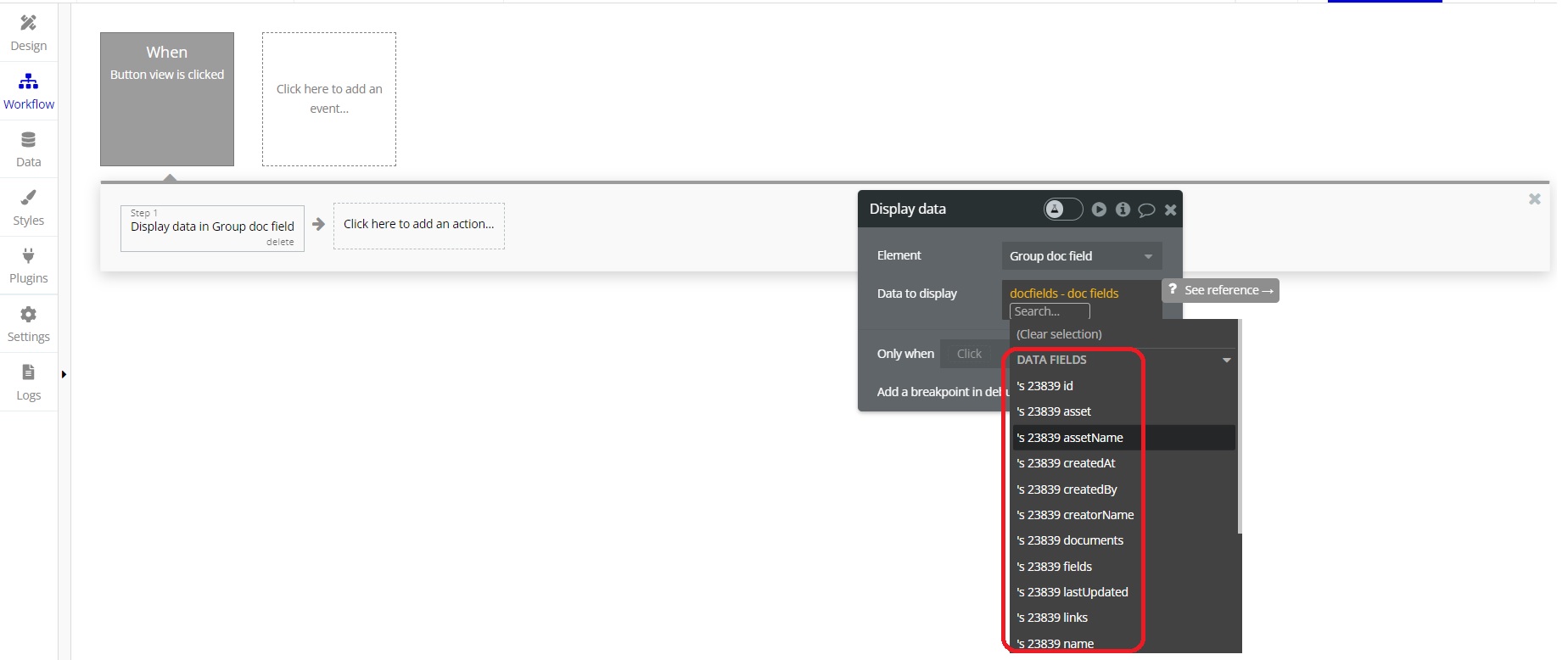

Attached the images of the API call and workflow pages. You can see when I try to map data, it shows only the value I entered in the API call as it is hardcoded.
As a result, I am able to get only the data of the particular id.

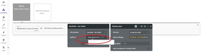

The input value is not hardcoded, as you can see from your last screenshot, you can dynamically input the (path) id, and the call is being set up correctly.
The dynamic expression in the second screenshot (the one showing all the 23839s) is just making available the response of the API.
The 23839s are actually in the key values of the API response. The API you are calling is prepending the ‘id’ associated to the call to all the key values.
This practice is a form of namespace isolation, and I personally hate it. The benefit is that supposedly it helps to avoid data conflicts (accidentally putting the data of one account in another account), disadvantage is that its a pain to deal with.
I fyou set the dataType of call to JSON, the Bubble API connector will not be able to handle namespacing, because it cannot handle dynamic key names. After initialisation, all subsequent calls will have different key values ie (23839 id → 24259 id) and the API connector will not retrieve them.
You will have to set the Data Type to ‘Text’ and manually parse the response on the clientside

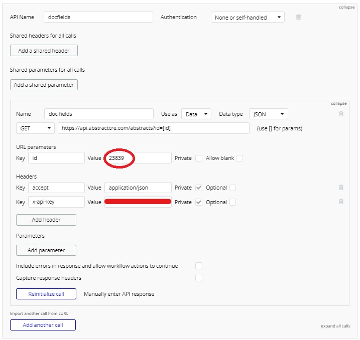

The actual problem is we are able to GET the data only associated with the id no: 23839 (which is given as sample in API config).
We are able to map the input text data to the API call, still the result we get is only from the id 23839, no matter what the input is given in the text box.

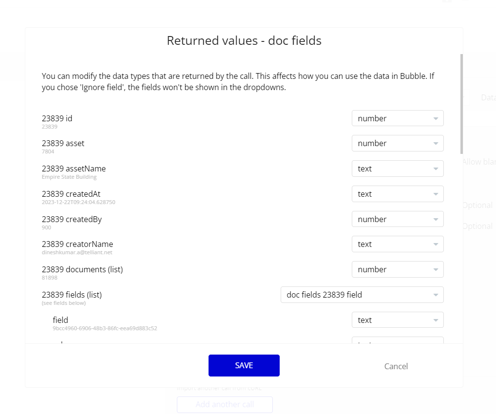

Can you share the initialisation popup of the API call that isnt working properly?
@nico.dicagno
Please look into the initialization popup of the API call.
Hope it helps.

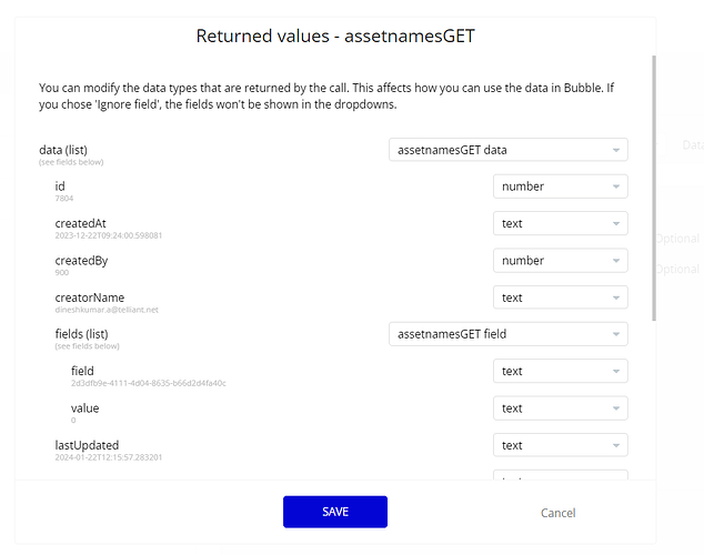

Can you also share a screenshot of the Initialisation call using another id please.
@nico.dicagno
This is the initialization call for another data field, but set up in the similar way.
I’m able to get data output for the input data I provide in the UI for this call.
But, in the one which I face problem, it shows as the dummy id is bound with the call. So, it gives result for the same id, but not for any other id (even for valid id).

Ok. I stand by what i said in the first post. The problem is that the API uses name space isolation.
Re-read my first post carefully
I can try to give a better explanation:
The API is actually always returning the data of the ID requested in the UI. However the problem is that the API uses namespace isolation and the response keys will always have the requested ID at the front, which is different every time. The response keys are dynamic .
The API connector json parser cannot handle dynamic response keys.
When initialising the API call, the API connnector will set the key names to the the ones returned during initialisation, which will have prepended the ID you used to initialise.
In all future API calls, the parser will always try to find the values attached to those specific key names. But it wont find those keys, because the key names will be different, because you are using a different ID.
Solution:
Sadly you cannot use the API connector’s json parsing. If you want to get this to work, you have to set the ‘return type’ of the API to ‘text’ instead of json. This will make the response of the API just a block of text. You’ll then have to parse this yourself using :extract with regex or even using a JSON parser plugin.
