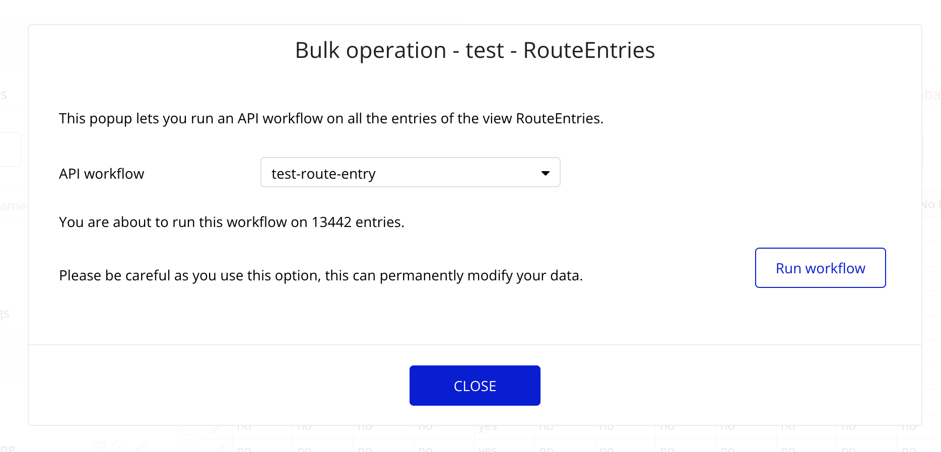

Where is the limit of 1000 per bulk? I am able to bulk edit 13k records (I didn’t tap Run Workflow so maybe this limit surfaces later?)

Hey Greg, actually when I said max per bulk I was referring to the data api /bulk option.
Which actually got an amazing new update to run 8X faster!
That flow you’re running you can do 13k items
Basically it just pushes the full list through the api workflows on back end one by one, it does it pretty speedy depending on plan.
