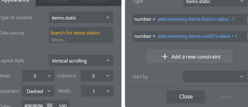

However, I think I noticed that you fixed it. So basically you changed:
To:
If you could elaborate on this, my brain can’t process this :wink:
I don’t know why it was broken, I suspect it is a bug with the way the list processing works with item numbers or something.
So instead of using #item it the list, I am just searching for numbers between your from value and to value, having sorted the list into item number.
So if you have from = 1 and to = 14 you search for > 0 (so 1) and all the way up to < 15 (so 14).
Hm yeah exactly. I didn’t understand why you would switch methods but if you say it could be a bug, I fully believe you :wink:
The only downside to this method is that I need to make sure the number thing is actually a number and not a text which keeps me from using leading zeroes which makes it more difficult to create a unique ID for the QR to link to (1001 for inventory 1 and item 1, etc.)
