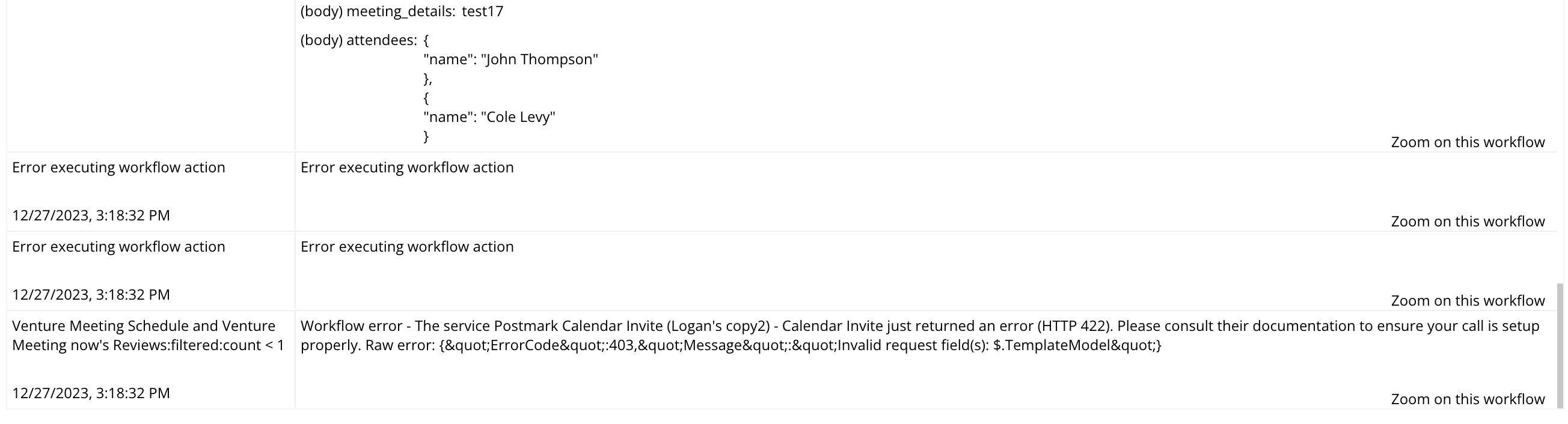

Alright, I might have spoke too soon. I am stuck again on getting the correct formatting for the list of attendees.
It will initialize if I leave the value blank, but I can’t seem to initialize it when I put in static data on the value or when I use dynamic data:formatted as text.

This is what I have now:
I also checked to make sure it wasn’t anything else, when I remove the dynamic data for the attendees it works, so I am pretty sure it is something in there (my guess having to do with commas and/or delimiter).

I ended up getting this part to work. For anyone who finds this and is struggling, this is what I did…
I kept pretty much everything as seen above. The only change that finally made it go through was to make the Participans:format as text as follows
SO in the content to show per item section I have it as:
{“name”: dynamic text:formatted as JSON-safe}
Then for the delimiter I have:
NOTE: There is a space between the colon and the dynamic text. ALSO, there is a space after the comma.
