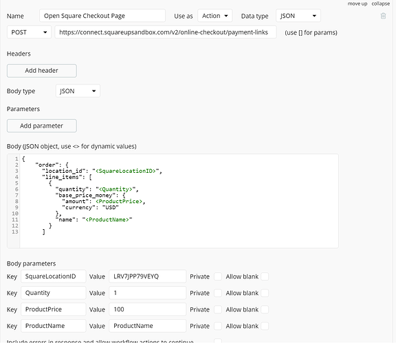

I need to integrate Square instead of Stripe, which I am hoping to do so via API Connector. But either way, I don’t understand how to send an itemized list of products that the customer wishes to purchase.
I was able to initialize the follow:

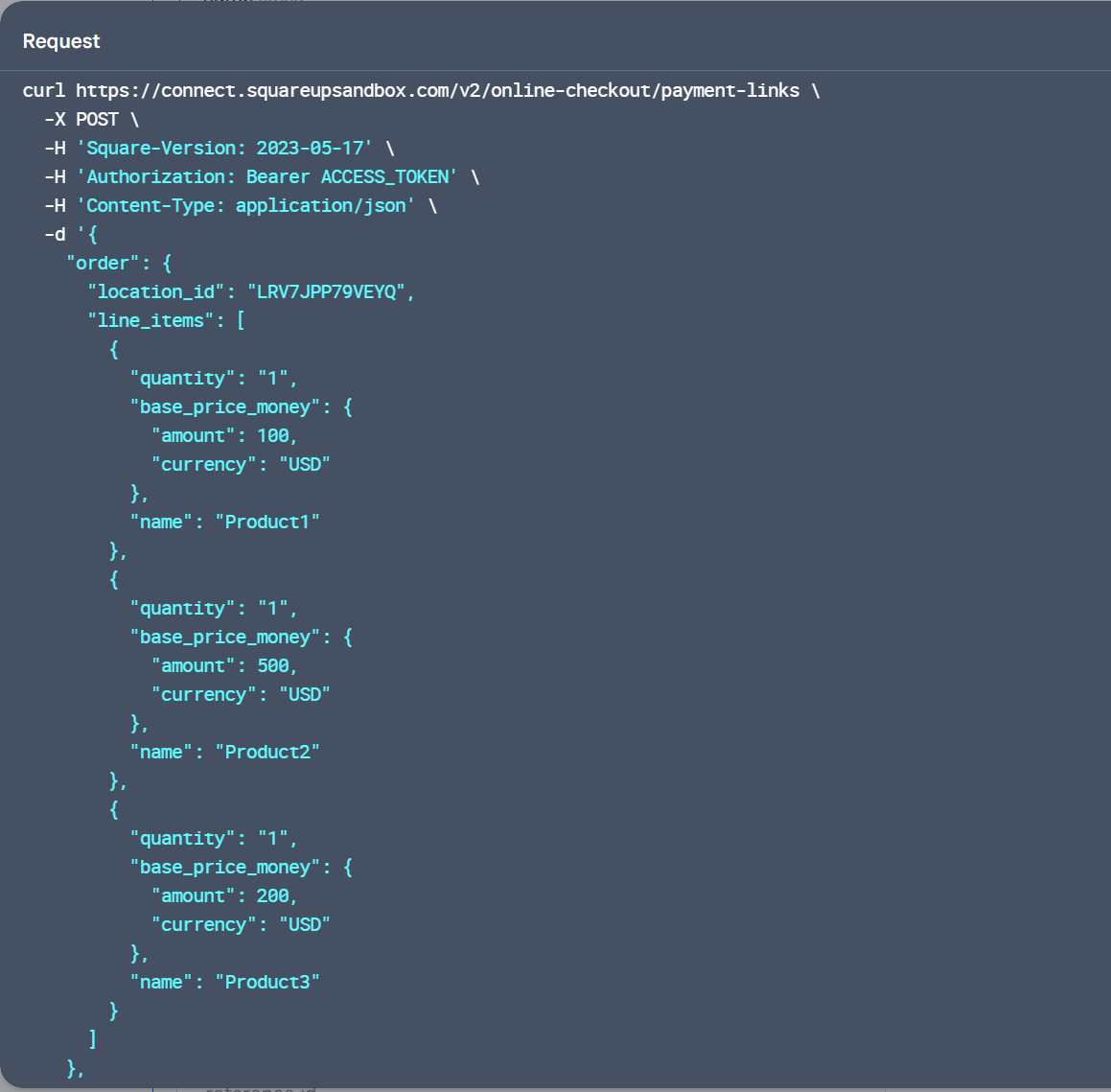

But I need to be able to have a dynamic list of line items so that the request looks like this (this example as a list of 3 line items but this needs to be dynamic):

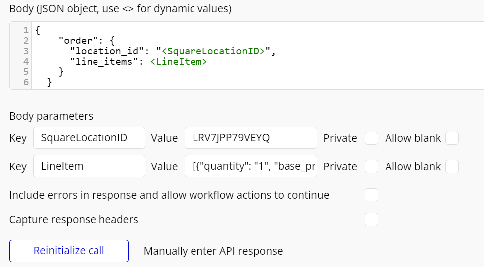

I was able to modify the above API call to this:
with the value of LineItem being:
[{"quantity": "1", "base_price_money": {"amount": 100, "currency": "USD"}, "name": "ProductName"}]
But when I edit my workflow, the request is giving me errors:
I tried to fix the errors, but the 3rd error message doesn’t make sense to me because I think that would break the JSON syntax.
Error 1: "invalid character '[' looking for beginning of object key string (line 4, character 123)"
Error 2: "invalid character '{' looking for beginning of object key string (line 4, character 121)"
Error 3: "invalid character ':' after object key:value pair (line 4, character 31)"
UPDATE: I have removed all the spaces from the syntax. Error still shows. If I add format as JSON-safe, a new error pops up "Expected an array."

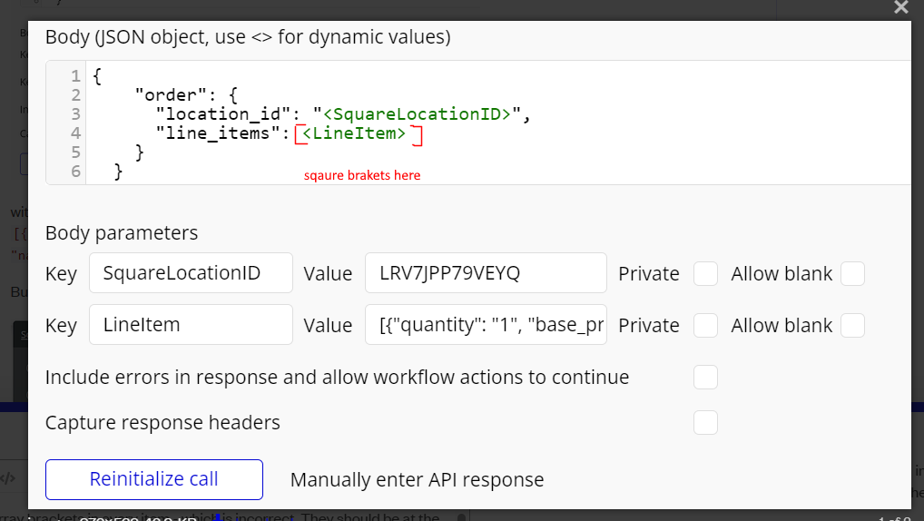

Yeah, you’re including the array brackets in every item - which is incorrect. They should be at the start and end of the array only - with everything else inside them.
The simplest way will just be to add the square brackets to the JSON in the API connector, and keep everything inside them dynamic.
Or you can add them in the LineItems dynamic value in your API Action box
e.g.
[Search for Carts: first item’s: Cart Items: format as text]
Thank you. The first solution worked.
I tried the 2nd solution, but another similar error occurred. I also thought it was an index issue, so I tried a [count - 1], but that didn’t work either.
Now it does.
