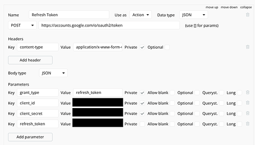

@orka
Set up two API endpoints like shown in the screenshot attached.
Let me know if this helps.
