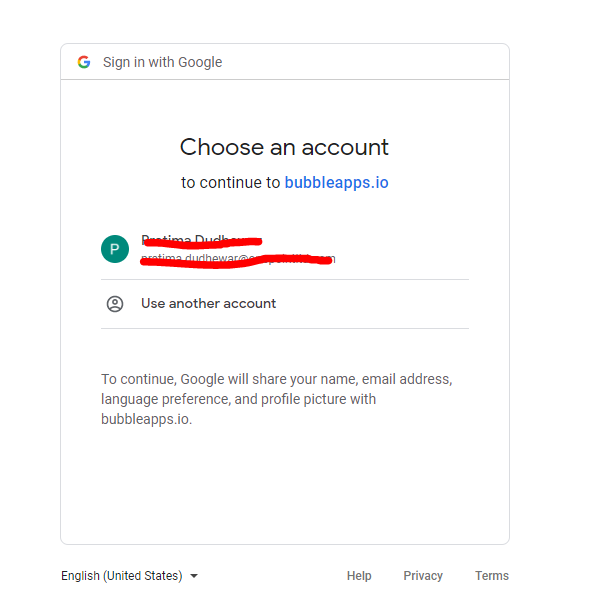

Btw just one thing can you send me that link “open external website” which you have in screenshot? Also what is that state parameter you put as"12345". Should I copy it from URL?
Also will ping you here if i stuck at any point. Once again thanks a lott. :grinning:
Hey @it18
after selecting the account from consent screen getting below error.
Am i missing on something?
This is kind of Temporary ID (not realy important).
Hmmm, at this error i dont know how to help you…
At this stage, any error you receive should be caused by, an error in the redirect link or an error in Google Cloud console settings.
Did you set your redirect url and right scopes in google cloud ?
Share your google console ss, then we maybe find out something wrong.
