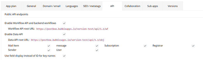

  2. Enabled the necessary API endpoints settings for my app

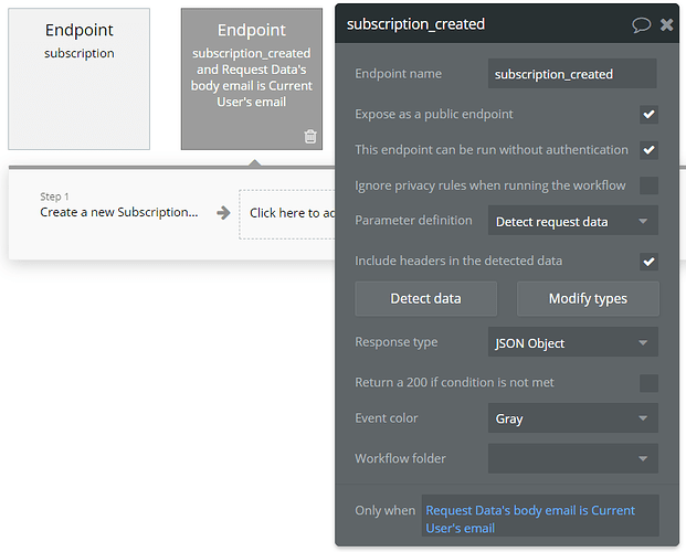

  3. Created an endpoint named “subscriptions created” that automatically detects data from the webhook
  4. The data was detected successfully when using the endpoint URL (https://postbox.bubbleapps.io/version-test/api/1.1/wf/subscription_created/initialize) for Paddle to send the webhook to.

Hi,
Your endpoint is https://postbox.bubbleapps.io/version-test/api/1.1/wf/subscription_created
The initialize works just once (when you enable it) to allow you to map the incoming JSON.
So, in your payment app, just change the webhook url to https://postbox.bubbleapps.io/version-test/api/1.1/wf/subscription_created

One last thing: the data is being saved in my dev database. Would you know any way on how to have the data saved in the live database?
Just remove “version-test” from the link.
https://postbox.bubbleapps.io/api/1.1/wf/subscription_created
