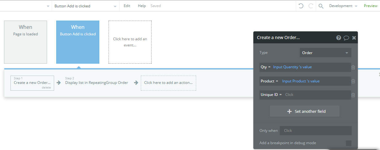

Thanks so much for the explanation. I have a sample of the app below
The Text element is to show the autonumber combination n page load
the repeating group should show things added using the add button and include their unique serial for example first item added should have serial number 1 etc

@adunniola ok, think I got the spirit of it. Have a look at this page. You’ll need to log in:
You can click the logout button, and login as a different user (email: test1@test.com, pwd: test). You’ll see when you create a new order the S00xxx order number gets incremented globally, while the item #s in the order restart at 1 for each new order.
I had to change your data structure, play around and have a look at the data tab and the order-test page in the Editor. Happy to answer any questions.
