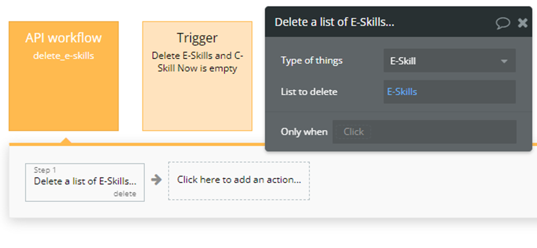

Backend - Delete list of "Things" that reference a different "Thing"

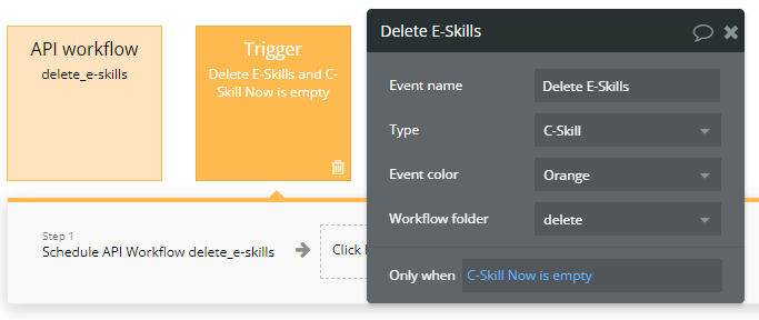

I have a backend workflow that schedules an API when a database triggers.
I would like to delete all things that referenced an item that has been deleted.
i.e. When “C-Skill” is deleted, I want to delete all the “E-Skills” that previously referenced “C-Skill”
I’m not sure where I’m going wrong, but it’s not working for me.
I’d appreciate any advice on how to do this.
Hi there, @rory.mulligan… I could be off base here because I am not necessarily following your exact flow, but I think it could be “flawed” at a base level because it sounds like you are trying to delete a list of things (E-Skills) that are no longer associated with a thing that has already been deleted (C-Skill). If that is the case, you likely have to go the other way and delete the list of things (E-Skills) before you delete the thing with which they are associated (C-Skill).
Does any of that make sense and sound like it might describe what is happening?
Best…
Mike
Hi Mike, you are right. It could be just me not fully understanding the capability of Bubble’s backend workflows.
I assumed that using the expression “C_Skill Before Change” would identify the list prior to when the “C_Skill” was deleted.
Is there another way of identifying a list of “E_Skills” that contained the “C_Skill” before it was deleted?
I don’t think so, but why can’t you delete the list of E_Skills" first by searching for the ones that are associated with the C_Skill that is going to be deleted. Then, after the E_Skills are deleted, delete the C_Skill.
I just thought there might be a way of doing it from the backend and that it would be quicker for large lists.
I’ve adopted your suggestion, it’s definitely a simpler way of doing it.
Thanks
