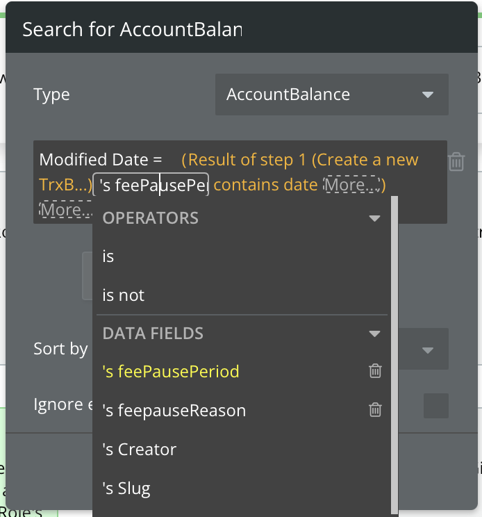

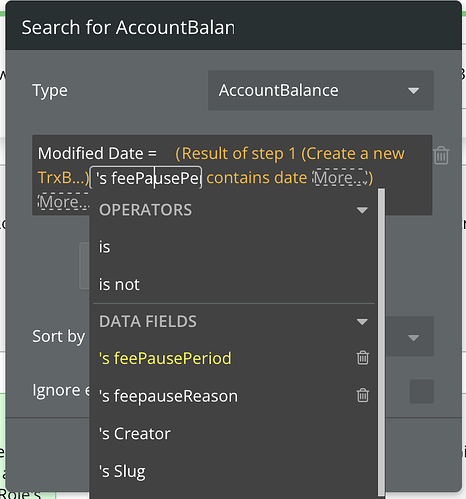

so then i thought about just triggering the use case manually on the front end when FeePause is actually entered but i wasn’t able to define a Do a Search for User’s AccountBalance that were modified during the date range feePausePeriod…

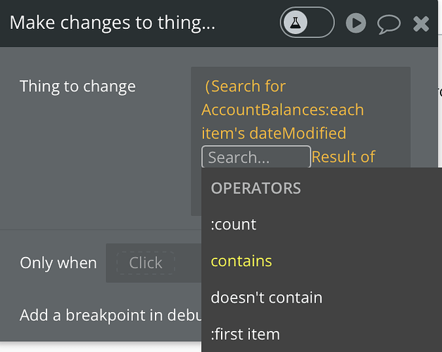

so then i added a field to the data type AccountBalance which is a list of dates when the AccountBalance is modified (dateModified) and tried defining a Do a Search for AccountBalances:each item’s dateModified that IS IN FeePause’s feePausePeriod (date range) iow AccountBalances that were modified in that period… but that was a dead end as well… sigh…
so now i’m thinking the manual workaround (changing every AccountBalance directly in the DB or building out admin functionality to sort AccountBalances by date modified and manually triggering credits) maybe isn’t so bad if nothing better works (urgh)…
