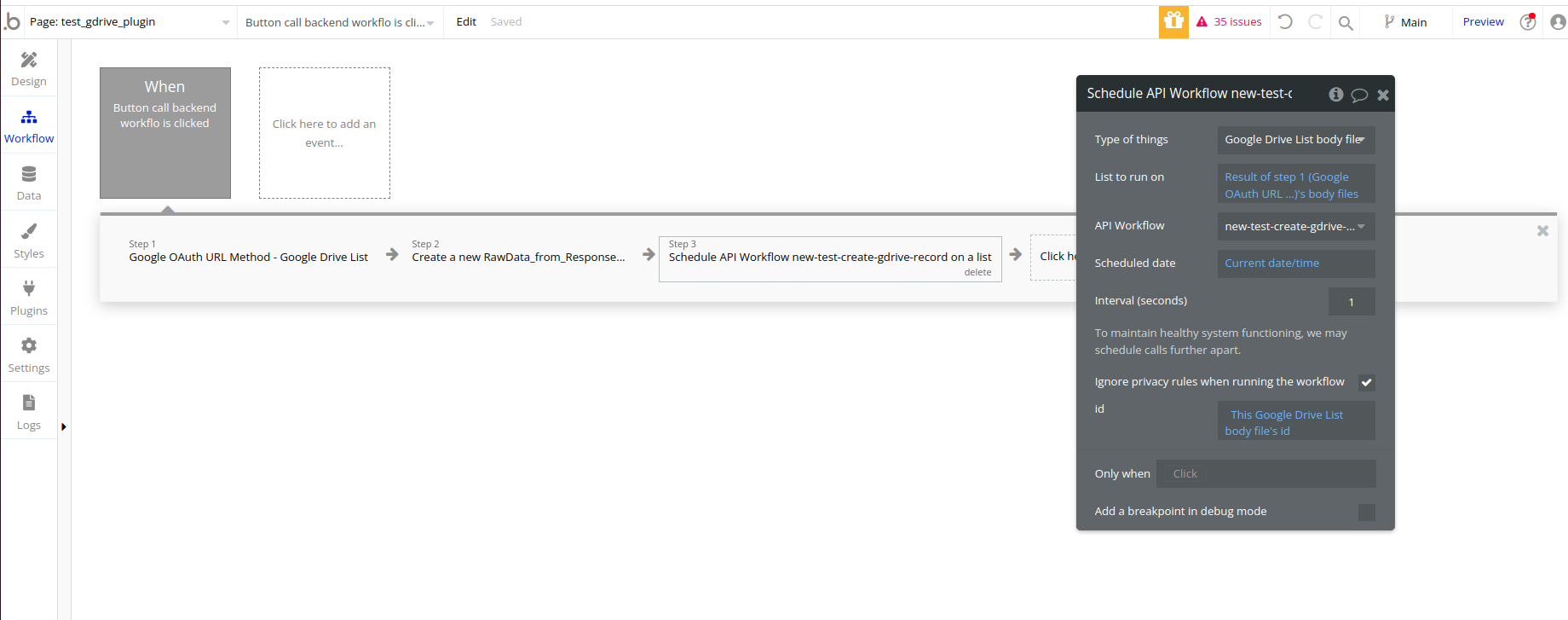

Here are some more screen shots to help get a better picture of what I am doing in the cut down debug page and set of workflows. Thanks in advance for your help with this.

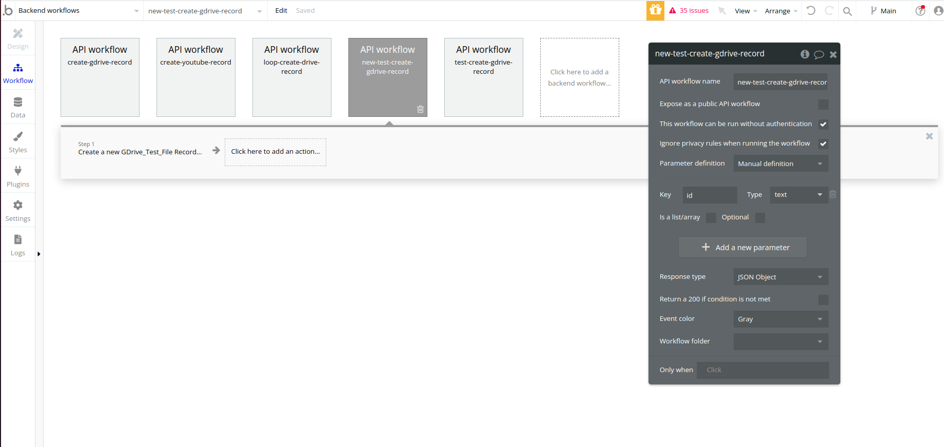

I just realized that I sent the wrong screenshot. The Raw data Versus what is going into the Backend workflow is this.
Does that look normal?

Per Boston85719’s recommendation, I built a new much simpler version of the Google Drive API call (using same authentication as I doubt that could be the problem). This one just asks for file Id and does so with the parameters
fields : files(id)
pageSize : 3
mimeType : mimeType contains ‘video/’
It initializes perfectly. I also created a new version of the datatype and I created a new version of the backend workflow and … I am still getting the same error.
From the same api call that fills a RG perfectly, I get
Raw Data captured =
{“files”:[{“id”:“1xQ-qXxCN7amU208adekCAfvFA6ZyHUKH”},{“id”:“1of_FJqNNXaOqFtALsDFHR0nAlf6BVrzm”},{“id”:“1c9Guwm6b6CvPGCNppi_AnH-f3f-4Jdtn”}]}
What I see being fed into the Backend workflow is :
Run a list on : [{"_class":“StaticObject”,“data”:{"_api_c2_id":“1gMNNoMhC7w5R4OYvBnEhuJMSp4LMgV4G”,“body_raw_text”:"","_id":“01d81853a5643bdf7900532c62976a4e”},“value_id”:“api.apiconnector2.bTHlz.bTImB.files”},{"_class":“StaticObject”,“data”:{"_api_c2_id":“1bSbNzs7siNqI5JkEpei3n7r1kX1YEpki”,“body_raw_text”:"","_id":“2e7bf3bc9c3bb1112c92da2c09208570”},“value_id”:“api.apiconnector2.bTHlz.bTImB.files”},{"_class":“StaticObject”,“data”:{"_api_c2_id":“1Asp_tcXNGLNgwkNZMqJiLGiiafyKE6HM”,“body_raw_text”:"","_id":“87b3718d6795b0a78e17cb950cd902e1”},“value_id”:“api.apiconnector2.bTHlz.bTImB.files”}]
Do either of you have any suggestions on what I could be doing wrong? I have logged a bug but am still open to being told that I have done something stupid.
The values you see on the Run a List on is Bubble ‘code’ I believe…you see the same type of stuff when you do list operations on backend workflows using entries from the database as well.
Try to run the workflow on a page instead of the backend workflow. Have it run for a single item to see if it works. If it doesn’t, them something might be wrong with the workflow setup. If it works, then try to not send the ID of the file and instead send to the backend workflow the actual file. Looks like your backend workflow parameter of ID is a text which is not a file, so all your backend workflow looks to be doing is saving a text value equal to the file ID, which is not a file, but instead just simply an ID.
