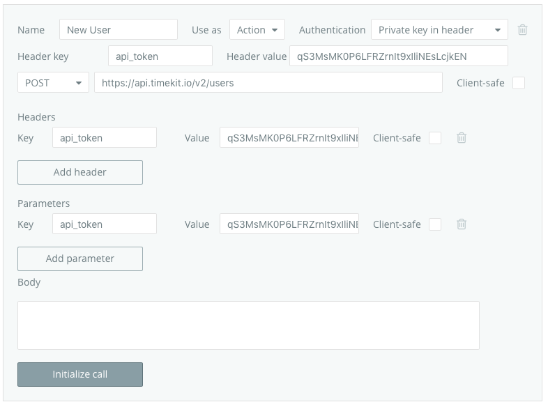

I am new to creating apps, and am learning so much with Bubble. I really appreciate the value that it creates, and enjoying the process. Currently, I am running into issues with API’s as this is completely new to me.
I am getting the following error. Since I don’t know APIs, and there are at least 2 places int he API connector labeled ‘header’ I don’t know what the error is referring to.
I can not figure out why I am getting this. I have tried filling the ‘header’ with the ‘Content-Type’ and ‘value: application/json’ as described in the BMI video, and I still get the same result. I have also tried with the API token as in the etsy video, and still no go.
If it helps, there is documentation here
link](http://developers.timekit.io/v2/docs/users)
Screenshot of all areas filled
Thank you for any help you can offer!
I believe you need to supply a header called “Timekit-App” - their documentation shows this as an example: ‘Timekit-App: docs’ I would assume that the value (in their example “docs”) would correspond to what you’re looking to access on Timekit (I’m not familiar with the service).
Looks like they provide a simple example (using a UID/PW for authentication) on the “Authentication” page. You’ll need to pass a basic JSON structure, it appears, containing the UID and PW. Looks pretty straight forward, but you’ll need to put this into the Body section of the API Connector call and then modify it (as necessary) in your workflow/call.
