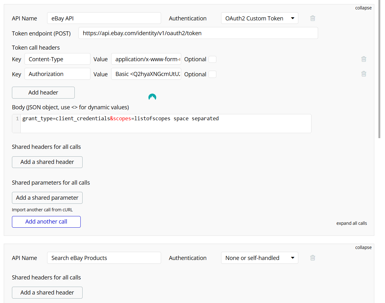

I tried setting up OAuth2 Custom Token with the client_credentials flow, but I ran into issues. Specifically, the API Connector doesn’t seem to recognize the token response properly there’s no field for “JSON path for token” or “Token prefix,” so it doesn’t automatically attach the token to subsequent API calls.
Has anyone successfully set this up with eBay recently? If so, could you confirm:
  1. How you structured the body parameters (grant_type=client_credentials and scope) in Bubble?
  2. Whether OAuth2 Custom Token correctly handles eBay’s token response, or if you had to use None or self-handled instead?

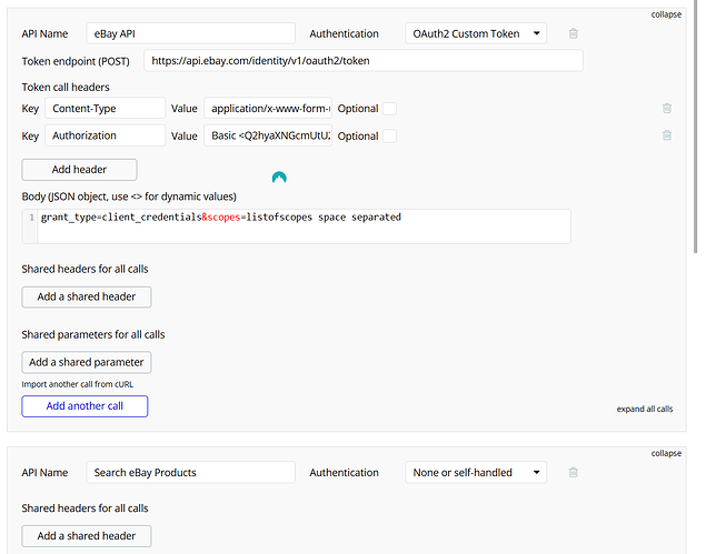

No you can use custom oauth2. How did you set it? Screenshot?
Bubble will automatically set other API calls authorization with header “Authorization: Bearer access_token”. No need to do anything for that. No need to tell Bubble the JSON path for the token because this use a “standard” oauth2 process.
For the parameters, it could be it the url or in the JSON body, but using grant_type=client_credentials&scopes=listofscopes space separated"
Also, you need to add header for token with Authorization: Basic <B64-encoded-oauth-credentials> and another header for Content-type: application/x-www-form-urlencoded

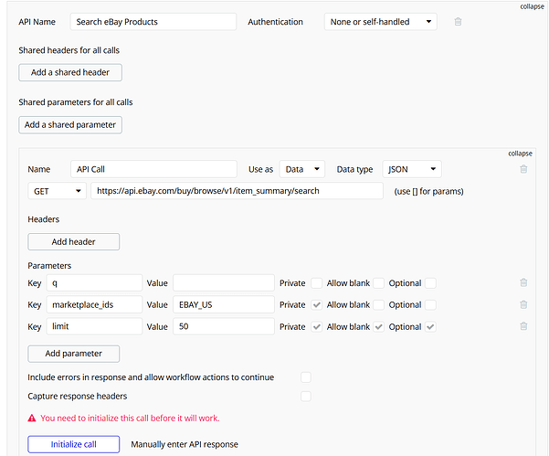

I also then have underneath

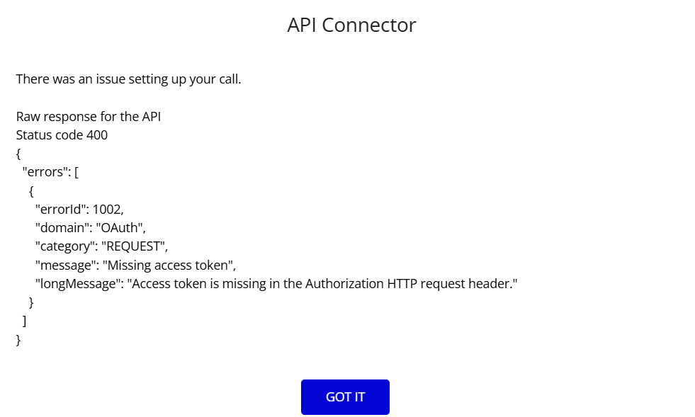

Then when I click on initialze call i get
You didnt add the call at the same place of your auth. You created another api connection. Look where you have the custom auth, click add another call. Not another api.

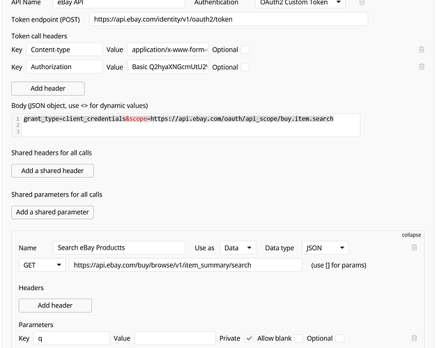

I just moved it to underneath the API rather than another connection

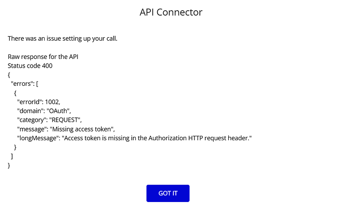

And now get the following
You need to url encode scopes. Not sure if bubble do it or not automatically.
