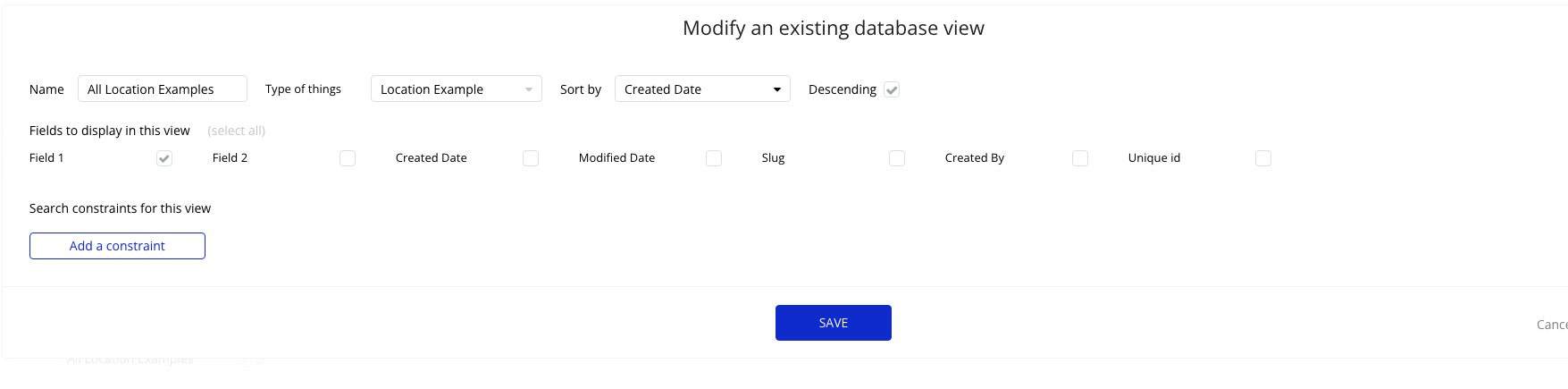

Just create a view in the DB and export for that one field or combination of fields…
The example data type below has two custom fields and the built in fields
Changing what fields are in my app data DB view in the editor to the below, to only include one custom data field
Now from the below screen shot area, if I pressed export, my csv will have only that single field for all entries in the DB available to the view (ie: I can add constraints to narrow my search to only the entries I’d like to export) in the CSV, which is equivalent to exporting a data type that had only that one field on it, so no aggregated/group by searches required…
But if you are referring to analytics for in the app to display via the app, there is no way around aggregated/group by searches no matter the data structure, and in fact, both data structures required the same setup just as in the export from DB.
