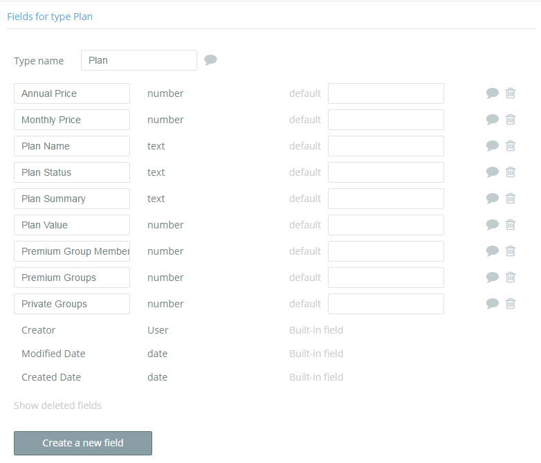

Ok. So this is how I am approaching this now. Still a work in progress but is looking quite feasible.
Have a data type called ‘Plan’ and create a field for each feature.
Instead of a binary switch for each field, make each field a number
You need to decide on a field by field basis whether the field value is implicit or explicit.
Implicit would be something like Free = 0, Basic = 20, Advanced = 40 etc). Explicit would be something like ‘Members’ = 5 (meaning 5 members is the threshold for that plan).
Numerical fields will support implicit and explicit values. Just remember to make use of the notes in your data schema to keep track of this.
So to give you an example from my app and how this is coming together.
In my app, users create groups. In the free plan a user can have 1 private group (a group allows the user to store a collection of things).
Private groups are restricted to the group owner - no additional members can be added to that group.
In the basic plan, the user can have 1 premium group and 5 private groups.
A premium group on the basic plan allows the group owner to add up to 3 additional members to the group (so number of premium members would be 4).
You can see in the excel table how these values can be mapped to the plans.
Where fields are explicit and are always threshold values, you can set extreme upper limits for your top plan to support ‘unlimited’:
Here is a view of the data type to support this example.
Note: This could also be extended to include feature flags.
