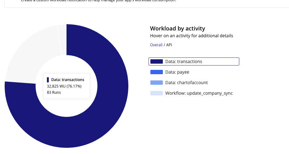

We’re building a financial tool using Bubble as the frontend and our own backend API to pull transaction data from QuickBooks.
Each company can have more than 100,000 transactions and we need to:
  • Display all of them in a repeating group
  • Allow inline editing for each field
We’re currently pulling data from our own FastAPI and writing data into Bubble’s internal DB using the Data API so we can support easy editing and real-time updates. Also this save some work unit by Bubble handle all data pulling and writing. Using an external DB could make the UI experience clunky — updates don’t reflect unless we refresh the page, which breaks the workflow.
The issue: Even uploading via Bubble’s Data API, writing 100k records costs around 400,000 workload units, which isn’t scalable.
Just wondering — has anyone run into a similar situation?
