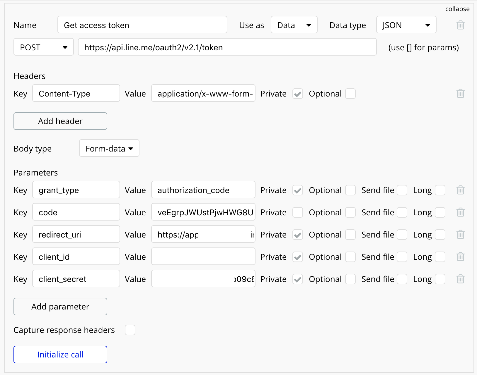

Body type: Form-data in API connector not works. The API requires application/x-www-form-urlencoded (Solved)
Hi everyone,
I’ve tested and it did’t work. Both Postman and Bubble. How can I make it work while the API connector does not have application/x-www-form-urlencoded body type.
Any solution to do this?
Thanks in advance.
S
Here’s the API requirement
Here how it goes in API connector
Result

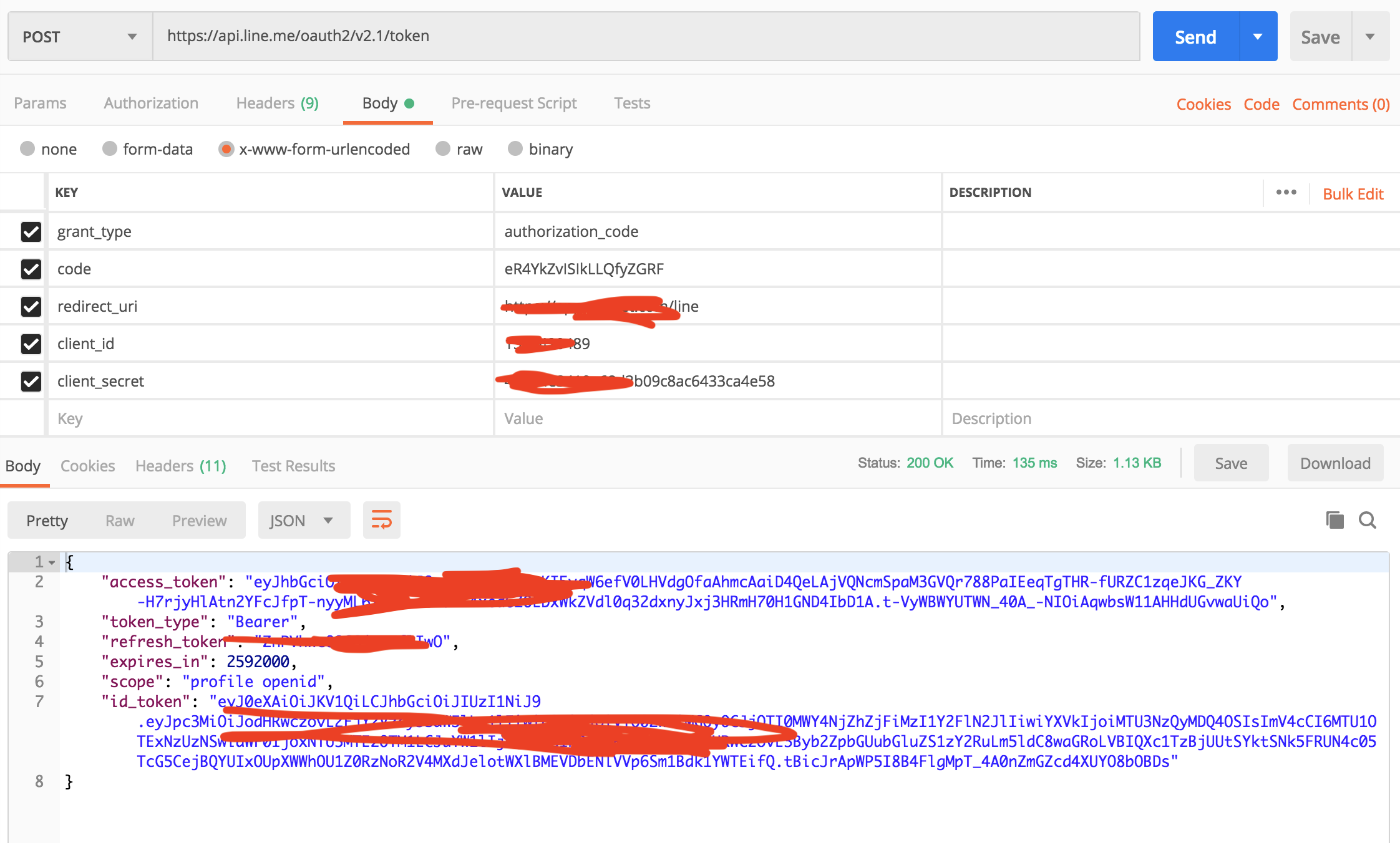

Postman (Form-data)
Postman (application/x-www-form-urlencoded)
Hey,
Try to change body type from the form-data to JSON.
Here’s an example of the body:
grant_type=authorization_code&code=…
BTW, you’re trying to get tokens via OAuth2 method. The Bubble already supports that method.
It works!
Thank you so much <3
