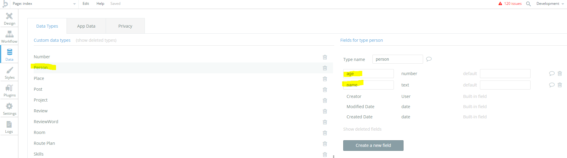

Both the API endpoint “person” and thing “person” are available in the open bubble app.
API endpoint →
“person” thing →
The “person” thing is simple and contains only two fields - name and age.
The JSON payload contains two persons and that data is in an array.
I’m having a bit of problem in defining the bubble API endpoint parameters correctly. For example, should the key type be “person” - since the data should update the “person” thing or “text”?
