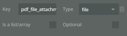

The specific issue I am having is that I am sending a pdf file to my bubble endpoint, and it is showing up as shown below:
Is there any way to accept this file into bubble as Key = pdf_file_attachment; Type = File? (See below for example)
If this won’t work as described, is there another way to get a pdf file into bubble using the endpoint?
Thanks so much!
Yes, you need to send this as described here

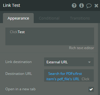

I am trying to store the information in a customer PDF object as follows:
It creates a data entry as follows:
Then I try to access it through a link element as shown below:
I have been unable to figure out how to make this work and any help would be incredibly appreciated!

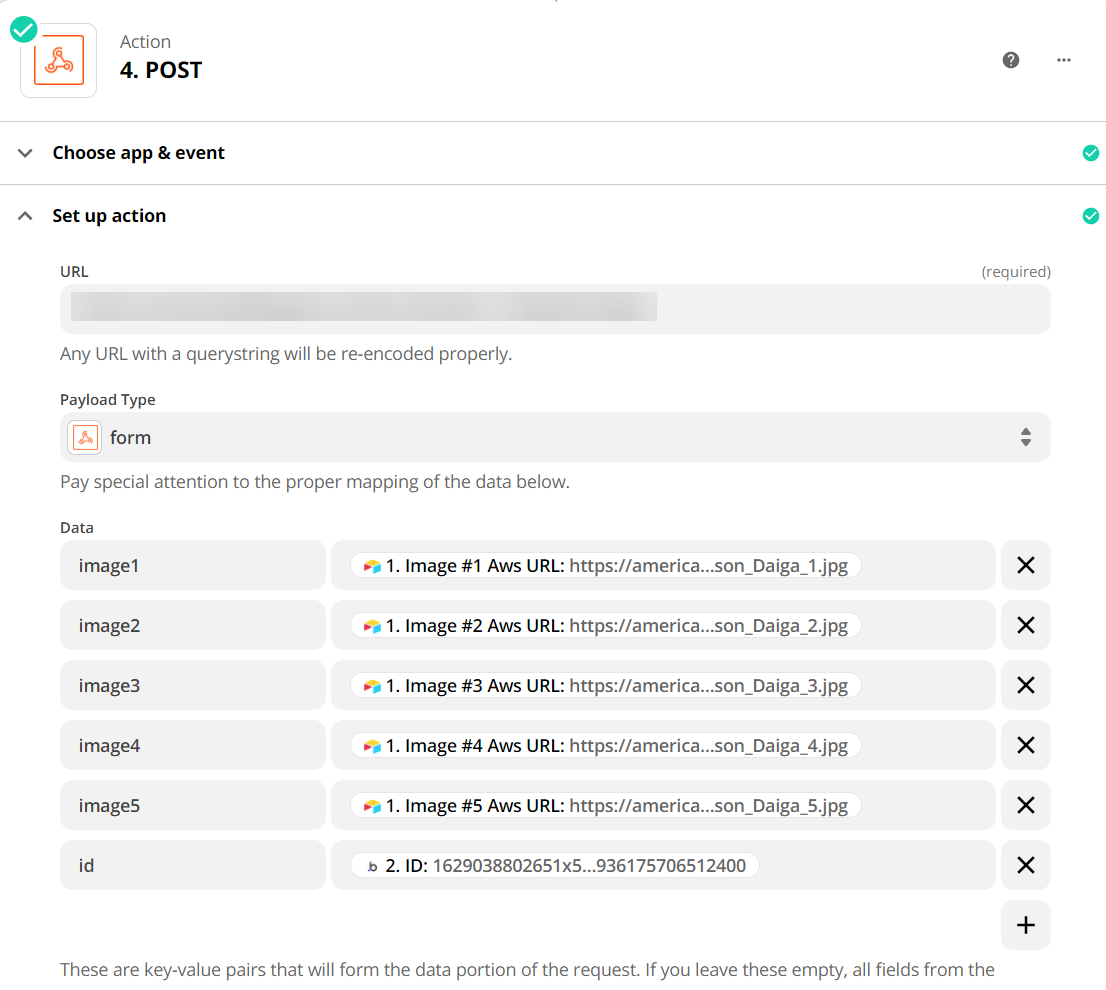

I’m encountering the same issue that @saeed.t.richardson described five years ago - trying to move images from an AWS bucket into Bubble via Zapier but finding my original AWS link is getting stored in the image field in the Bubble back end as opposed to a link to the file on Bubble’s AWS bucket. That subsequently means that integrated Imgix processing doesn’t work, and the images are broken in the Wonderful Image Slider plugin, and both of those things are big problems for my use case.
It sounds like an alternative could be to get data into Bubble and then kick off an API workflow to lookup and import the images that way. Or just brace myself for manually uploading a few thousand images after getting the rest of the data moved via Zapier.
With some help from Matt at @RapidDev, I was able to make Zapier import all my data including images. The key is to configure an API workflow that makes changes to a thing’s image fields with a URL that leverages the saved to S3 action. Then in the Zap, after the step which creates the Bubble thing, add another step that sends the image URLs and the ID of the just created thing to the API workflow. :tada:
