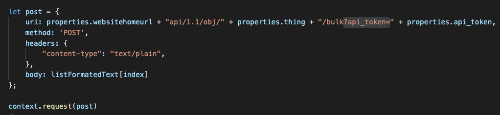

This is how i initiate my Post Request:

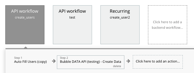

I activate an API Workflow that structures a .CSV file to a plain text formated for the Post request.
then I use the previous API Call to create my users.
I also try with a plugin to manage my request and avoid server to get too busy but it does not works :
I also have tried to trigger data base event on list of Objects to simulate a bulk create thing but is does not work as well as I thought.
