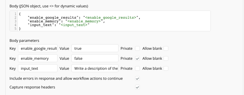

This is how the API JSON body is setup in the API connector
and to reiterate the issue only happens when my input text contains quotation marks around a single word within the content.

What is the full payload with the text? Can you send it to requestbin? Or just copy the text value
Unless I’m misunderstanding something, it should be as simple as using Bubble’s :formatted as JSON-safe operator. And since it automatically adds double quotes around the value, you don’t want them in API Connector Body field.
So something like…
    "input_text" : <input_text>
Thanks @sudsy
when I put after the dynamic expression the input text the operator :formatted as JSON-safe, I get the same error even after removing the quotation marks from the JSON body of the API connector.

The :formatted as JSON safe did in fact do the trick, I just didn’t take the approach correctly the first time.
I did alter the API connector API call by removing the double quotes around the dynamic parameter value in the JSON body the first time, the issue I did not address the first time was the fact that the call itself had both static text and dynamic text and I added the :formatted as JSON only to the dynamic text (as only can be done).
Based on the fact that all 3 of the respected community members were emphasizing the use of the :formatted as JSON safe, I took another swing at it, and this time in the workflow for the API call I used arbitrary text with :formatted as JSON safe and I put both the original static and dynamic text into the arbitrary text and it worked! Hooray!.
