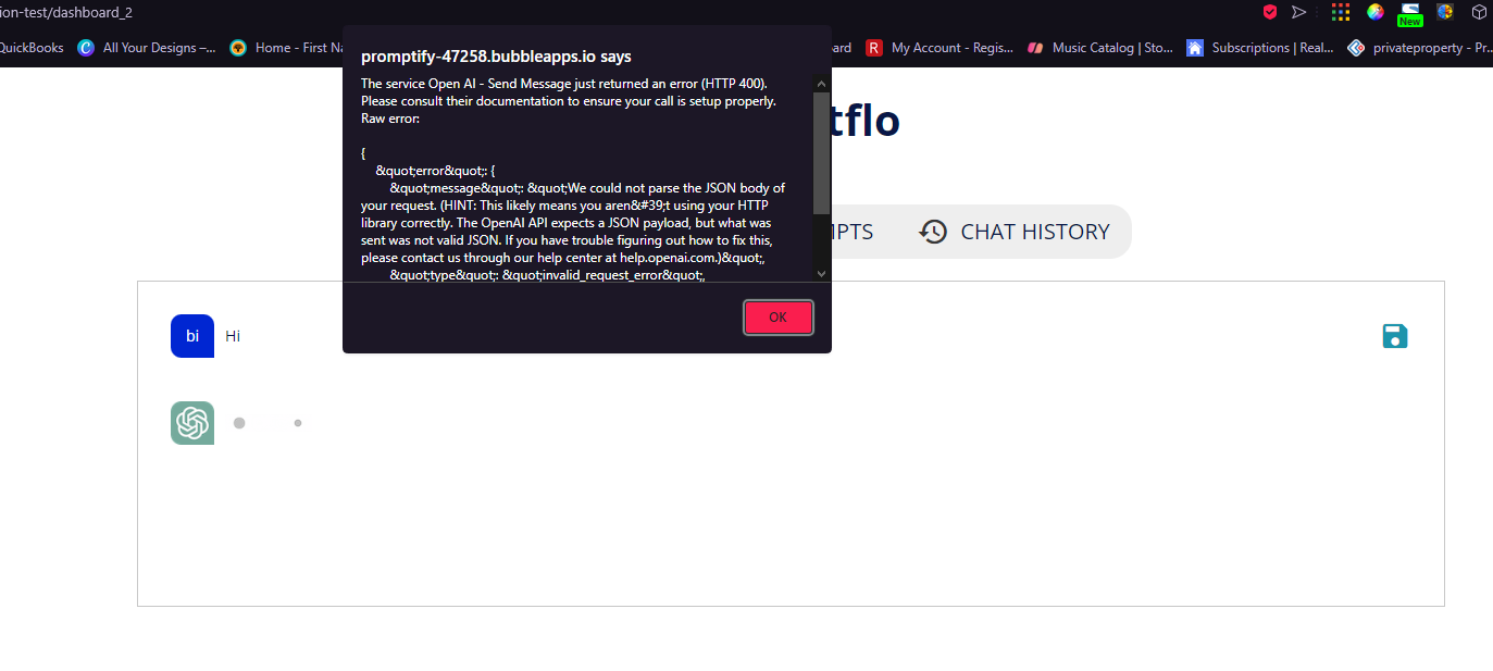

ChatGPT API give me an error when using "" in my prompt
When I send a prompt that has “quote” like that I keep getting an error that says the Json format is wrong.
I tried the Jason safe method, but that didn’t help either. What am I missing?

I’m still getting the same error, the moment I remove the quotes around “<message_content>” then it doesn’t even matter what else I do, I still get the same error, event if my prompt is a simple text prompt

I just used the JSON Formatter, here is what it gave back to me when I remove the " " around the variable.
Okay good. Now, remove the quotes around in Bubble (because Bubble will add these for us when we :format as JSON-safe). Take your multiline input, use that value:formatted as JSON-safe in the API call and you’re good to go. If it doesn’t work, the issue is that you don’t have the Content-Type header set to application/json.

Okay so I removed the " " around the variable.
API
prompt
Error
