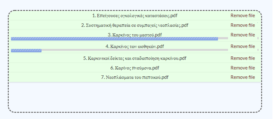

I interrupted the upload at about this point by closing browser tab:

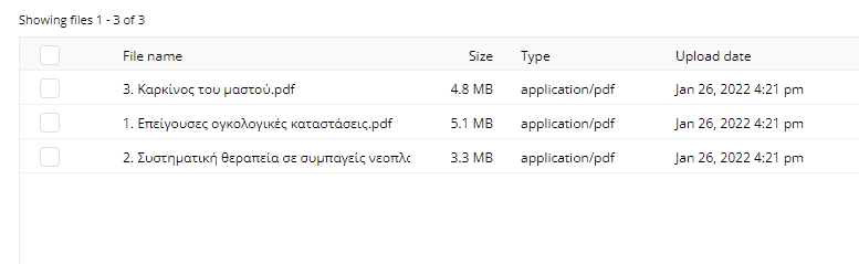

After refreshing the file manager I these files were registered (in the time between the screenshot and until I closed the tab another file finished uploading):
I am unable to capture these already uploaded files, they will take up space and I won’t be able to track them or scan for them to automatically delete them.

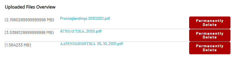

In contrast, when the files do finish to upload, then using the “Multi file uploader value is changed” I can track the files and I can create records that allow the user to delete the uploaded files.
However, this isn’t possible if the the upload process is interrupted, which in turn creates untraceable files.
