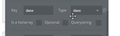

Also, can you show the setting of your API Workflow? (parameters)
I too think it may be a setting within the app builder.
The page variable is set to Foundation/Date data type and is the only iOS “date” i could select.
On the Bubble end, it’s set to receive a ‘date’ as well.
Can you switch to initialize and send the request and post the screenshot of the parameters?
We will see what exactly is sent. Even if you set Date, there’s a lot of way to format date.

Did ypu set initialize for auto detect params. You can also send the request to a requestbin. What we need to see is what is sent to bubble
