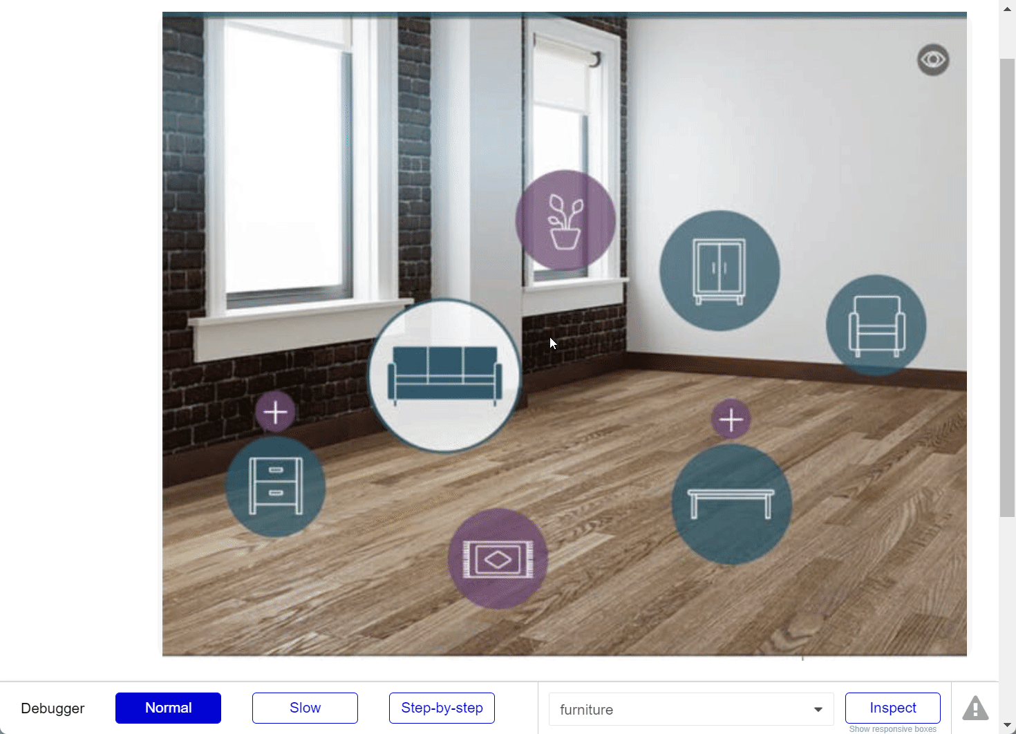

A lot is possible with Bubble. Example, create a group (type fixed) with an image element in it and place a couple of groups at the locations where you want the user to be able to click. Show a GroupFocus when the user clicks one of those groups with a repeating group which show the furniture options for that group/location. When the user clicks on one of the options, replace the original image with a new one which includes the chosen furniture, example
Result:
chrome_zxn5mGU7LU
Together with the suggestion from Licorice a couple of posts back in this topic you can get pretty far.
Note: To prevent using a lot of groupfocusses, you can use the drag/drop group (with the furniture options for a certain location), part of the Bubble draggable elements plugin. This group has the workflow action “move draggable group”. Together with the Bubble plugin Mouse & Keyboard interactions, you can show the group at the location a user has clicked.
