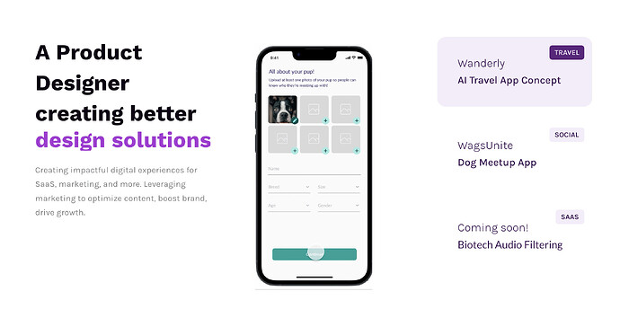

Button change on click
The right of the hero sections are buttons to change the video that’s displayed in the middle. How can I trigger the buttons to show like the purple one (the tag too) when clicked and like the other two when not clicked?
I got it to do it partially in styles, but it wouldn’t remain in the pressed state.
