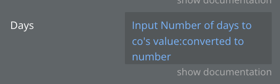

Problem 2: Specifying the Number of Working Days
Next, you need to input the number of working days you want to calculate. You can use an input value for the days to count, which can be any value from your database or user input. This allows you to customize the duration based on different project requirements.

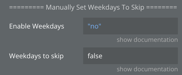

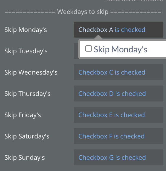

Problem 3: Skipping Weekends
Then you may need to skip weekends. By default, you can use fields with the “Skip” prefix to exclude specific weekdays from counting, similar to checkboxes. Alternatively, you can use the “Weekdays to skip” field where you send comma-separated values of the indexes of weekdays you want to skip. To enable this option, set “Enable Weekdays” to “Yes”. For example, entering 2,5,6 means you want to skip:
  • 2 - Tuesdays
  • 5 - Fridays
  • 6 - Saturdays
This flexibility is great for customizing which days to exclude based on your work schedule.
