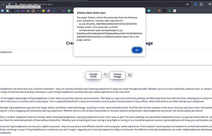

I’m using the Toolkit plugin with a Run JavaScript action when the icon is clicked but I get this error
The code is very simple (below) with the data being written to the clipboard coming from a dynamic custom state
Screenshot 2024-04-05 at 10.18.35
What am I doing wrong?!?

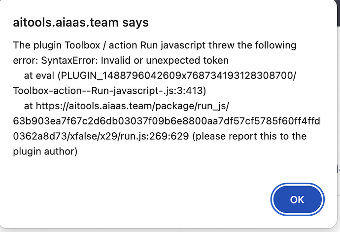

Tried that thanks
got this

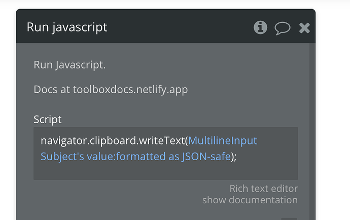

Have you used :formatted as JSON safe?
Use that method without quotes.
Thanks for looking at it…I’ll try that

Just to let you know that your suggestion worked thanks @GH5T :pray:t2:
This works fine…
