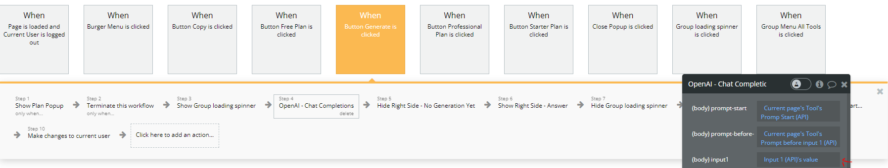

I am stuck. Here is my JSON BPI Connector Body
“model”: “gpt-3.5-turbo-16k”,
“messages”: [
{“role”: “user”, “content”: " }
“temperature” : ,
“top_p” : <top_p>,
“frequency_penalty” : 0,
“presence_penalty” : 0,
“max_tokens”: ,
“n”:
Here is how it looks in my workflows:
Thanks all!
