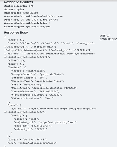

The EventBrite Webhook response looks like this:
I need to move data about the event into my Bubble database. How have others tackled this with other APIs? Can I use the webhook response directly or do I need to use something like Zapier to translate it?

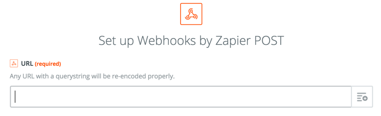

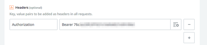

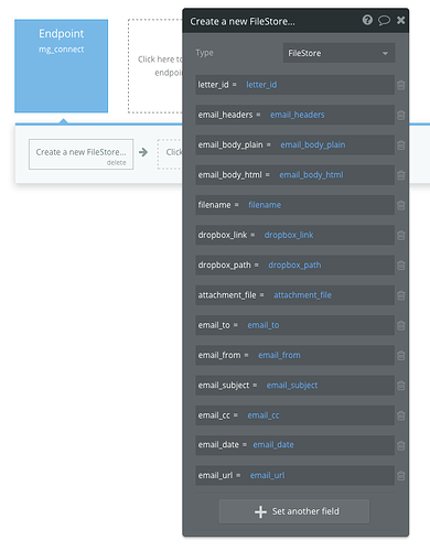

  3. Uses Zapier’s Webhook zap to post a number of pieces of the email to my app’s Bubble API to post (using the Workflow Post API). The API then stores data from the email and data from Dropbox to my Bubble app.
I’m including screenshots of my Zap and bubble API images for you to see.
Wedbhooks by Zapier, POST “Edit Template” screen actions
And headers for authenticating:
Bubble API Workflow Endpoint
Bubble API Workflow “Create New Thing”

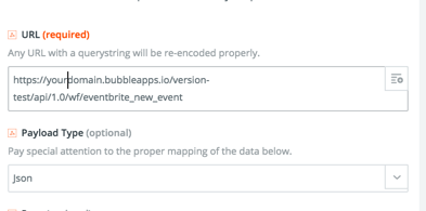

2. What Endpoint?
The API Docs tell you more about this. The long and short of it is to use the following convention for an API workflow:
https://appname.bubbleapps.io/api/1.0/wf/endpoint_name
or, if you have a domain configured,
http://yourdomain.com/api/1.0/wf/endpoint_name
Of course, the test version will need to utilize “version-test” in between the domain and api (https://appname.bubbleapps.io/version-test/api/1.0/wf/endpoint_name )
Hope that helps.
Awesome response. Got it working.

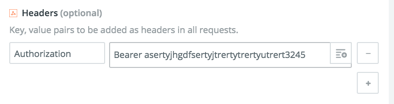

Adding some screenshots for future folks…
Soln to GET real-time data from EventBrite → Bubble =
EventBrite → Zapier (EventBrite Integration to a Webhook) → Bubble (endpoint)
1.Create an EventBrite Event
2.Create a Zap (EventBrite → POST Webhook)
3.Create Enpoint in Bubble
Presto!
