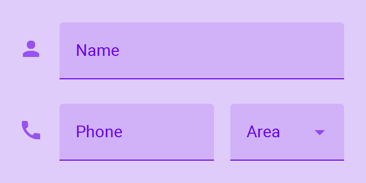

I was thinking about doing it. Right now I am styling things according to material design specifications.
Here is an editor with most of the design finished as well…I added the character count using the plugin by zeroqode ( countable )
Was getting ready to do the responsiveness, but all that was needed was for my purposes putting groups on the margins so the input wouldn’t shrink from 540 to 320 until after a certain page width.

Hey Boston,
So I played around for half an hour. Do you like this?
It’s way more simple and the transition is smoother. I am not certain how it will work with responsiveness, but there is only a single input and single textbox so it should be easy. The textbox is “behind” and the input box is “in front”. The text box is taller, and input is shorter and starts about half way down the textbox.
Let me know if this works for you.
Enjoy!

Just noticed a small glitch. Also add to the conditional… Or this text is hovered.
It’s not entirely perfect, but I like it will enough for a quick creation.
That set up at first glance seems awesome…I’m going to try re-creating it and will probably run with it.
Was getting a bit flustered with the conditional workflows I needed on my set up as they don’t copy over, so would be cumbersome trying to create complete forms.
After going through it I will update the thread on custom inputs with a credit to you. Always nice to get alternative ways to implement, especially when they are better.
It’s not quite as flexible as yours, but honestly i didn’t put lots of time into it. The annoying part is if you hover over the text rather than the input, it can’t make you type. But again, just a little thing to try. Bubble is nothing if not a mind puzzle.
I made some adjustments to the setup of the elements. I made the text element the same size of the container with background grey color ( both are 56 px height ). What I then did was change some of the padding settings for things to line up.
Essentially all conditionals are based off of the text element.
I created three different versions of yours. I like the last one which allows a user to hover with automatic focus on input…this requires a conditional workflow event and adding a shape to the group for setting the conditional workflow…however, I think it is awesome.
mutliple inputs
Thanks so much for posting your set up…has really made it 100 times better.
In terms of responsiveness there are no issues.
