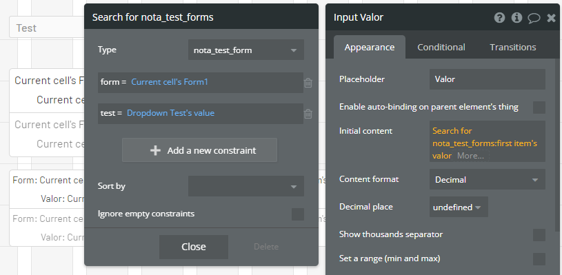

I’m having trouble finding a solution to the following situation.
I have several students who performed an assessment, I have to inform a grade and if the same was present.
A view of the table to be populated.
Does anyone have any idea if it’s possible to use a “while do” in repeat to insert!?

So, my doubt is how to make this insert of several students displayed in a repeating group
So you could do this a couple ways. If you want you could do this in a Popup or something so the teacher pressed a button to “take role” and it opens up the popup. But either way your workflow would be:
Make a repeating group with the data source being Do a search for Student so it lists every student. Inside the cell of the repeating group add some text like the students name, etc. Add an icon or button with a + sign. The workflow when you press the plus sign would be “Make changes to a thing” and change the current Assessment. The data to change is the Students add Current cell's Student
That’s the extreme basics of it but you might want to add a remove button to remove the student from the list, maybe put everything in a group inside the cell and use conditional formatting to highlight the cell when the students been added.
I can explain in more detail if needed.
I understood the logic! in the action when clicking to evaluate make the insertion one by one since you would have to put your grade. (has already signaled a solution)
My idea was if there was some way to insert (assessment and students in batch).
For bringing into the evaluation this total result in popup
Okay I see so you don’t really want to make a list of students under a test. Instead you want to store a list of Assessments under the test. And each assessment will have a student field, their score, notes, etc. So when the teacher goes to press the + sign to “take role” you could instead do “Create a thing” and make the type Assessment, set the Student field to Current cell's Student, and step 2 would be Make changes to a thing Current pages test add Result of Step 1 so it adds newly created assessment to the current test.
Hopefully this makes sense it’s hard to describe over text.
If you want to do this in bulk it is possible if you wanted some kind of “Check all” button. You’ll just have to get into API workflows which is also easy.
I tried to get more information today if there was any more dynamic way to populate the table with a single action based on the result of the repeat, but nothing! I was only able to do it with the understanding I had at the beginning of our conversation.
I’m still going to test the editing process, but that’s it!
If anyone in the future has some other way to populate this table with a single click with the result of repeat just say!
