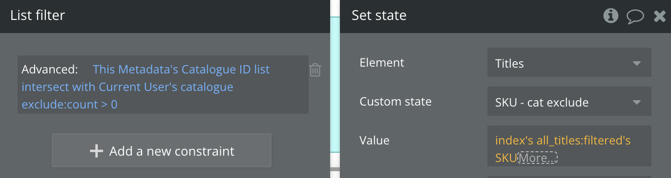

i’ve tried various advanced filter approaches which work individually for example:
Screenshot 2024-09-24 at 2.42.39 PM
and this works:
Screenshot 2024-09-24 at 2.57.54 PM
But i cannot find a way to combine them… it either just doesn’t work at all or the minus list filter overwrites the intersect with filter when combining them with OR.

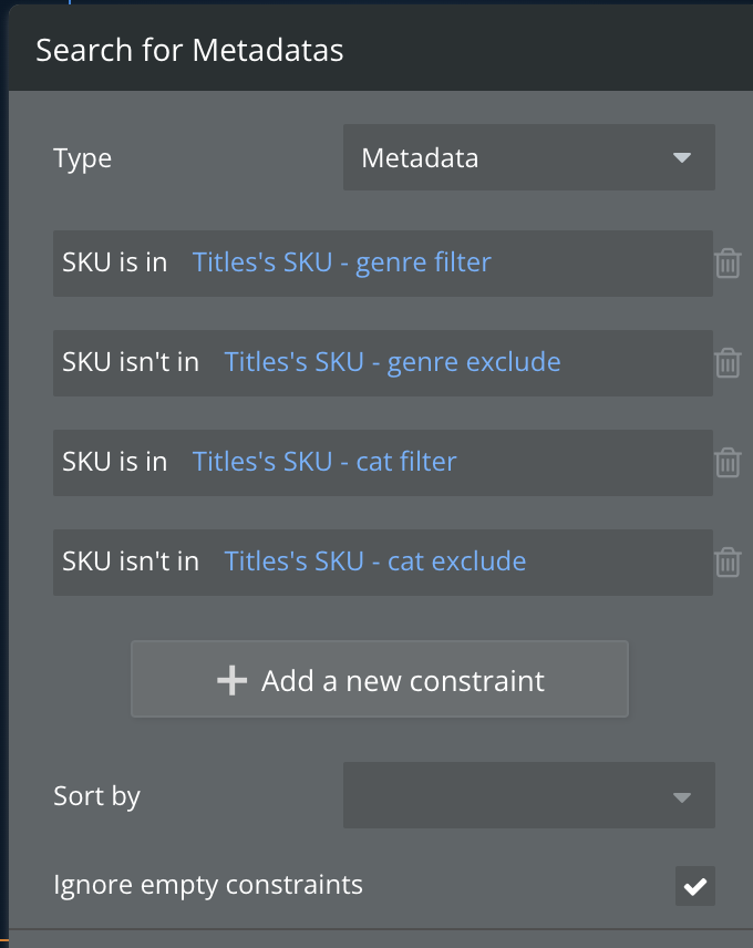

Ok so i figured out one solution for this… but i don’t know if this is really the best solution, feels a bit like a hack to me as i don’t know bubble well enough, but here’s what i did/found out.
The main issue i found was that one of the fields i wanted to filter was a list which meant using constraints wouldn’t work, so i thought what if i still use intersect to filter the search but now return the value of a single value field instead (I use SKUs in my database which is a single ID for each title), then use that field in the constraints.

  • I created a workflow on page load to do a search for the entire list and store it in a custom state.
    Screenshot 2024-09-25 at 9.09.21 AM
  • the next step i used a different custom state to filter this list (i had 4 different custom states for the 4 filter options, below is an example of one)
  • then created a new RG to appear when the Users role = filtered
  • As i now have 4 lists of SKUs based on the previous filtering, I set the data source for this RG as follows:
  • This way i can now use “is in” and “isn’t in” to match against the lists of SKUs, as they’re constraints they don’t overwrite each other.
  • Filter/Exclude is an OR option so genre filter and genre exclude can’t be active at the same time, therefore one would be empty which is why i needed to tick ignore empty constraints.
