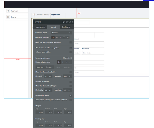

Please see the image.
My goal is to make the selected group (Group G) always be from the sidebar to the full right of the screen, both with 20px margins. However, the righ side doesn’t go the way I planned. What am I doing wrong here? Why is there no 20px margin on the right side?
NB. When I preview, I see the same.

I added the padding on the parent group. is there something wring with my other settings?
See screenshot of both groups (“group” and “parent group”):
Ah I think see your issue. Algemeen group cannot be 100% min or max width if you are giving it a 200 margin. It’s going to get the width of the entire page AND move 200px to the right.

Thanks. I think I have found an even easier solution: in group algemeen, I set the left and right margins to 0px, and added the values to the paddings. So I have 225px left and 25 px right now as paddings, and this seems to work fine!
There is only one downside: i dont see my floating group (the sidebar) anymore in de editor. Only when I make group Algemeen invisible.
