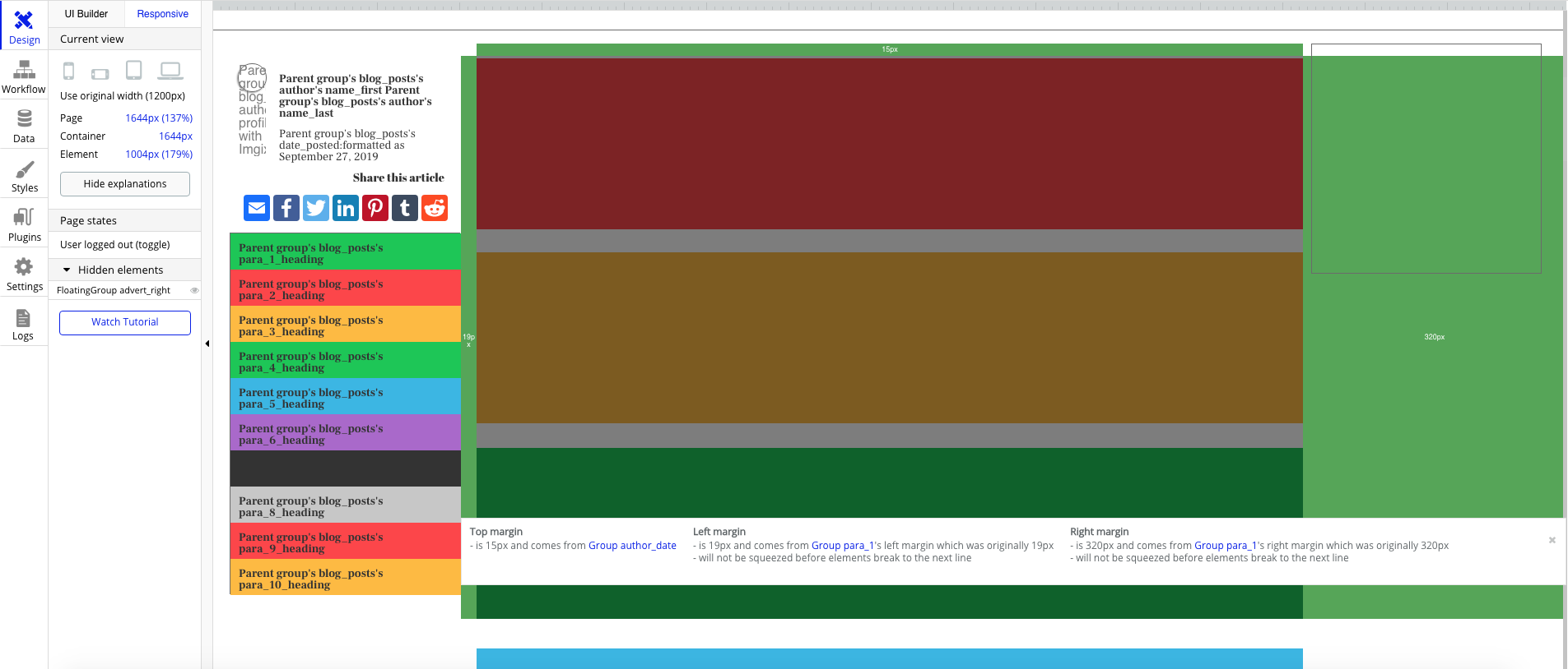

I am having an issue with a floating group that I want to be on the right side of the page. I have the page set up to be not fixed width so that I can make use of the responsive settings.
Everything is working as I want, except the floating groups. When the page is expanded the groups in the center of the page begin to overlap the floating group on the right.
The empty box with border is the floating group. The red and yellow boxes are groups that are centered on the page and set to not fixed width and no maximum width.
29%20PM
In the responsive settings there isn’t anything that really helps as floating groups are pretty limited in the choices. And so the only things I can do to play with the floating group settings are causing the floating group to be in a strange position on page expansion.
When the floating group has the fixed width then it is on the correct side, but again, the issue is that the colored groups in the center are expanding and the margin between the colored groups and floating group gets distorted. Not only is the margin between the colored center groups and the floating group getting smaller and eventually the colored groups overlap the floating group, but the right margin between the floating group and page is getting larger.
This is how it looks when the page width is 1200, which is what I set the page width to in the editor. I had aligned and sized elements so that the floating group on the right ( width 280 ) is at a 20px margin from the right side of page and the colored center groups.
I think that what is going on is that bubble is keeping the margins fixed for the colored groups in the center of the page, however the margins for the floating group are not maintained.

Hi @eli thanks for replying
That unfortunately isn’t working for me.
When I do that I get the same behavior as I did before. The center colored groups are overlapping the floating group
This is the page view
19%20PM
This is set up in editor
Seems like the floating group is rogue and isn’t adhering to any type of set margin rules.
@eli you got me thinking and I solved this issue
What I did was to resize the floating group. Originally I had it set to width of 280 px with a 20px margin on right (page) and left (centered colored groups).
What I did was to set the width of the floating group to 320px so that it took up the entire space. The floating group is set to fixed width.
I placed inside of it a group with fixed width of 280px and centered it in the floating group.
55%20PM
Now the centered colored groups never encroach on the group set in the floating group and maintain the 20px margins.
